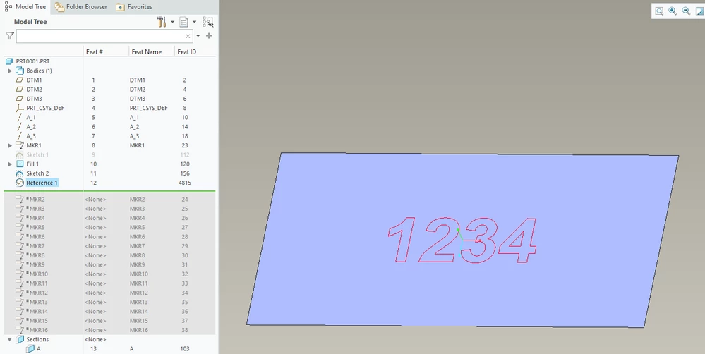

I'm modeling an object that I want to add embossed/debossed text onto, in a manner similar to what's illustrated here.
I want to be able to make the text easily editable, because it will serve as a label providing identifying information on the different permutations of this object.
If I try to go back and edit the text in the original sketch, it breaks the offset command later in the feature tree, because the specific curves that were projected in order to define the sketched region to offset no longer exist.
In the offset command, is there a way to tell Creo to project whatever closed curves exist in the original sketch, such that when the sketch is edited to include new text, the offset feature will be updated to reflect the new regions present in the sketch it's projecting from?
Apologies if any of this is weirdly phrased or if this is an obvious question, I'm a beginner in Creo.
Using Ver. 10.0.3.0

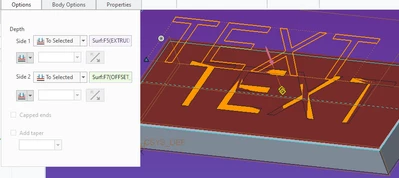

Unfortunately Offset>Expand>Sketched Region does not support text.
I am assuming the surface is not planer, I would suggest creating an offset surface then extrude up to the part surface and surface and set Side 2 to extrude up to the offset surface.

Aug 16, 2024 6:27 PM UTC
Here are a couple of ways to get what is shown in the video and allow for changes.
Copy the surface.
Extrude a solid of the text up to the surface.
Copy the outer surfaces of the text, using intent selection.
Trim the original surface copy by the text surface copy.
Select the outer surfaces of the text, by intent, and use remove.
Thicken trimmed surface.
or
Copy surface.
Extrude text as solid.
Copy outer surfaces of text using intent selection.
Use copy of original surface to Solidify remove material to remove text solid.
Trim original surface copy by text surface copy.
Hide or remove text surfaces.

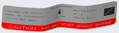

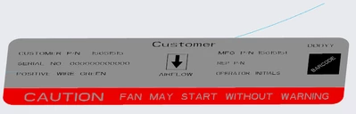

Aug 16, 2024 7:19 PM UTC
Depending on the shape of the surface where the label will be affixed, you can use the spinal bend feature.  Extrude the text onto the surface of the label while it’s flat and use a curve to define the final shape.  If the surface is always round or always flat, you can create parameters and use flexibility to drive the appearance of the label along with the dimensions of the spinal curve.  If the surface is irregular (like the example below), you’ll have to do something different to define each unique shape.

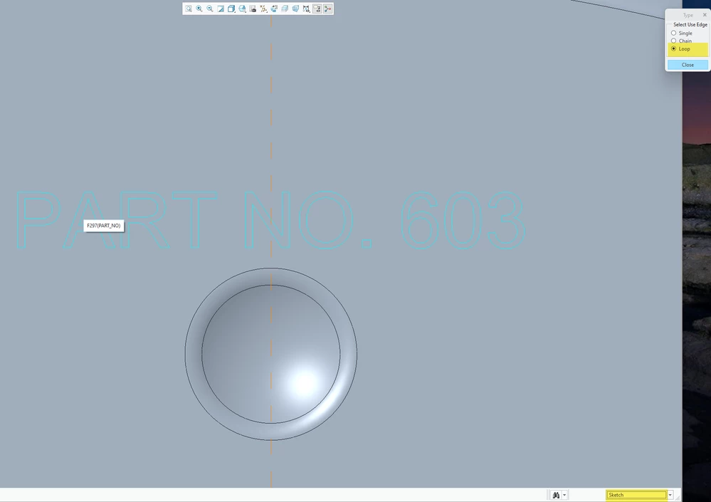

Aug 20, 2024 7:18 PM UTC
A tip for selecting text when doing this type of feature is the method to select the text with a single pick. This is an example of projecting the external sketch of the text for an offset surface feature (the internal sketch) with a single selection of a sketch. Set the selection filter to sketch (lower right corner) and then you just select manually one segment in the sketched text and Creo will include all curves in the text for projection. This also make rerouting the offset feature easier if one has to update the text string in the external sketch.
