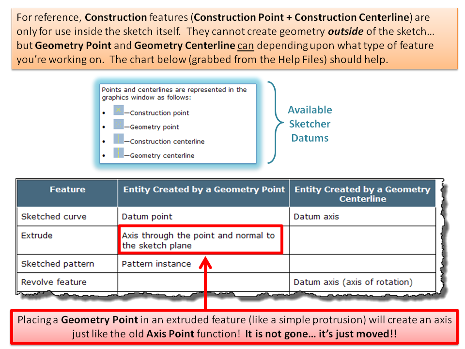

In addition to Tom's excellent reply, I wanted to add that to use patterned points in a sketch, be sure to use Geometry Points, not Construction Points. If you use a construction point, you will not be able to use it as the basis for a point pattern feature.
If you're having difficulty with point patterns, make sure you're using the right type of points!

June 10, 2013
Yeah they always were datum points until PTC removed the Axis Point option and then created the Geometry Point and the Construction Point.
Honestly I think they just confused things. It was easier to understand before. Add a point... and it shows up as a point. Add an axis point... and it shows up as an axis.
Had they allowed you to create an AXIS using a sketch even if that sketch was standalone and not tied to a feature (like a cut or protrusion), that would've been something. Instead they gave us this messy hodgepodge and most people couldn't tell you the difference between the two without looking for that table that explains them both (in the help files). Heck, most people don't know about the table! (See below).
Oh and the part in the table that says you can create an axis in a sketched curve using a datum axis is a misnomer. No one's trying to create an axis parallel to the viewing plane in a sketch (exceptionally rare). Instead, you'd like to create one normal to the viewing plane (like the old axis point function or like the new geometry point in an extrusion).
