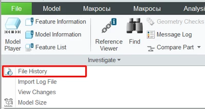

November 10, 2021
About the date. Did you know about "Tools - Investigate - File History" tool?
Steto13-AquamarineAuthor
November 11, 2021
Dear Ysintsyn,
I was not aware of that tool, I will check it out. Thank you very much.
Best regards
Stefano
