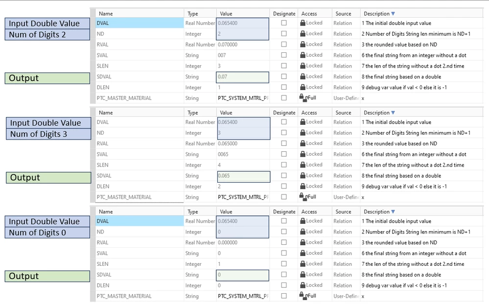

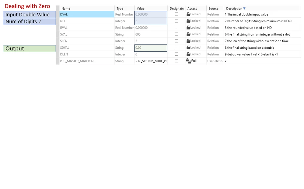

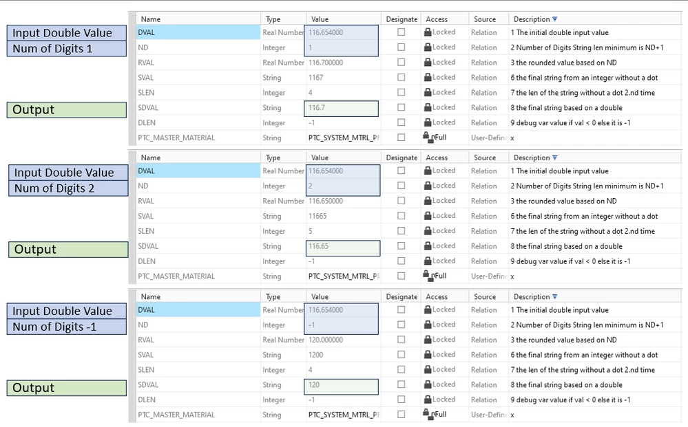

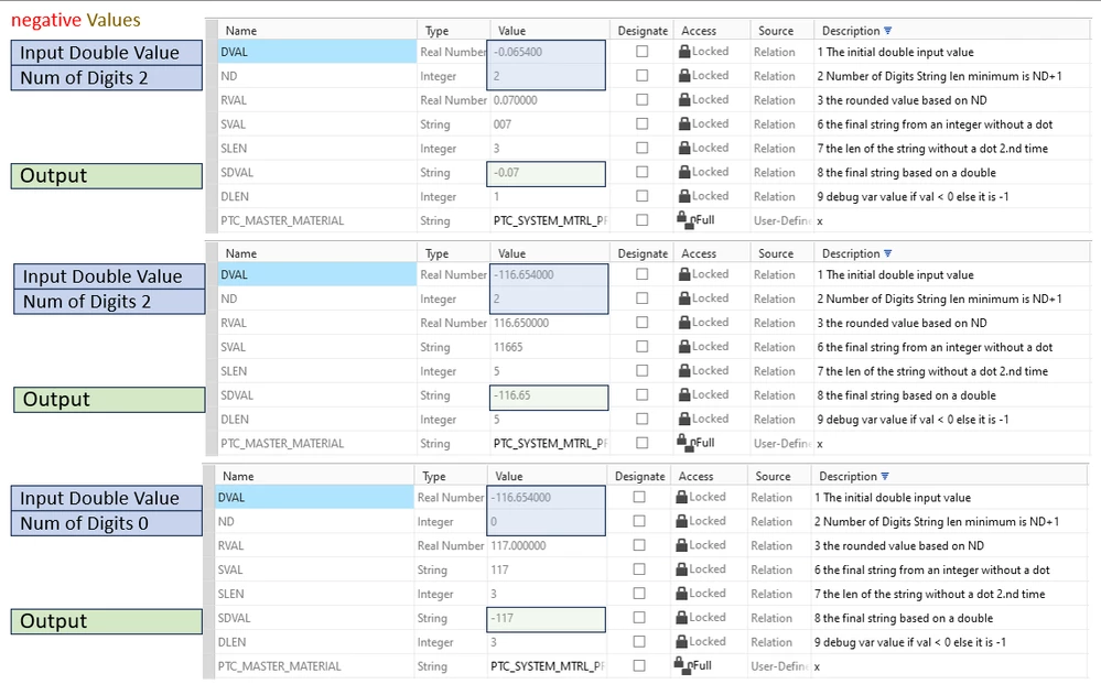

Apr 28, 2024 1:35 PM UTC
"Sunday bloody Sunday" 🙂
This is working for negative numbers and denominators (-,0,+) as well. Dependent on your needs, it can be simplified.
dval=1.399e-06
nd=7
Output would be -> 0.0000014
dval=-116.654
nd=0
 /* Debug Variable
dlen=-1
 /* get the postive rounded value
rval=floor(abs(dval)*pow(10,nd)+0.5)/pow(10,nd)
 /* multiply by 10 power of the abs value
sval = itos(rval*pow(10,abs(nd)))
 /* first string len
slen =floor(string_length(sval))
if (dval < 1)
 /* only for Debug
 dlen=slen
 /* Check if we need to prepend set new sval
 sval= extract("0000000000",1,abs(nd) +1 -slen ) + sval
 /* set new slen
 slen =string_length(sval)
endif
 /* only if you are okay with a dot at the end and no trailing number
if (nd > 0)
 sdval=extract(sval,1,slen-nd) + '.' + extract(sval,slen-abs(nd)+1,nd*nd/nd)
else
 sdval=extract(sval,1,slen-abs(nd))
endif
/* Final change for negative numbers
if (dval<0)
sdval='-'+ sdval
endif
