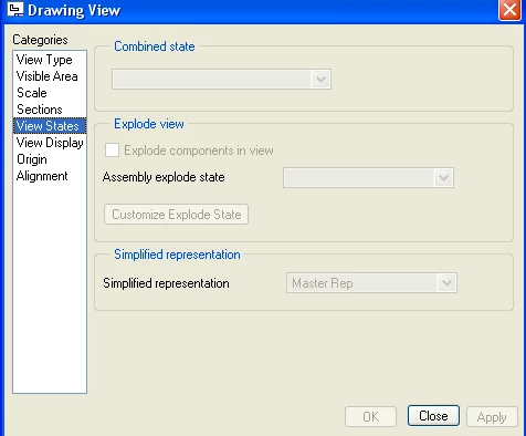

FYI, I'm only on WF3.
I can add a new view with the sim rep but can't seem to change the old
view. When I go to ViewStates, the simp rep is grayed out... In an
assembly, this is not the case.

Just to clarify something that was alluded to earlier. Part level simplified reps are treated like separate models. To create them you have to “add” the simplified rep to the drawing the same way you would add another model. Once that model/rep is active you can create views for it. You cannot change the view from showing the rep or not showing the rep just like you cannot take an existing view and switch it from one model to another. Again, this behavior is specific to part level simplified reps and the views of them.

I was thinking, “I switch simplified reps all the time in drawings”. So I did a quick test and yup, I was right and wrong.
In a drawing of an assembly, you can switch the rep anytime. In a drawing of a part, you can’t switch the rep at all. Just like Tom said, it’s treated like a separate part. It’s odd.
That being said, this is an excellent example of things you should do with layers. Make sure your drawing and model layers are independent of each other. Otherwise you’ll always be fighting with turning them on for the model and off for the drawing (or whichever way you need it to show).
In the drawing setup file (or in the layer status control) set the following:
draw_layer_overrides_model NO
ignore_model_layer_status YES

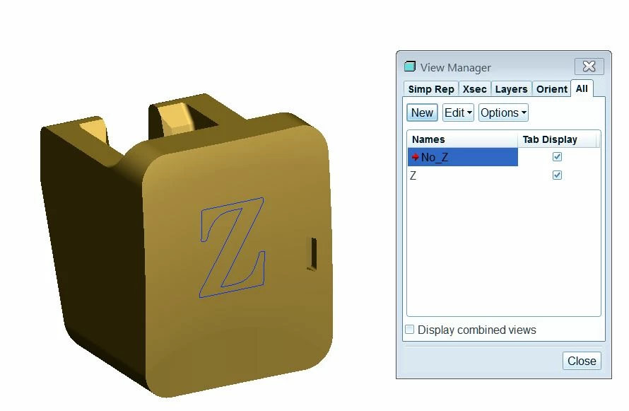

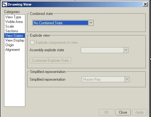

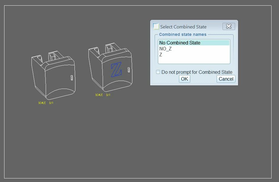

You may want to explore Combined Views with Simplified Reps.
Although still not as flexible as an assembly rep swap, but this offers some nice options on standalone parts.
Trick, on Z1 image, check the box (Display combined views) and in part mode you will get tabs to switch between.
Set this up on an assembly and now you have more flavors to choose from.
Great for design reviews to switch different things on and off.

July 12, 2013
But I don’t think you can change a drawing view rep once you create the drawing view of a part (assemblies yes, parts no) , not even with combined states.
That was the original question.
