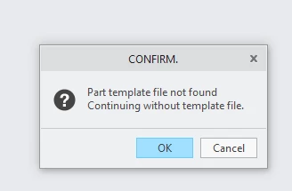

i am having a small issue, when i import a part, i am getting a error message that the part template is not found.
i have not changed any settings nor has anyone in the company changed anything either so im a bit baffled why the import function has decided to lose the default template

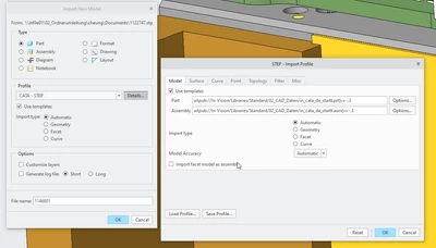

Hello, thanks for helping.
as you can see i have a profile and a template but despite that being enabled, as soon as i import it, the error message shows

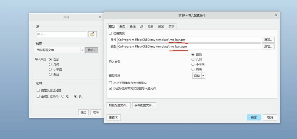

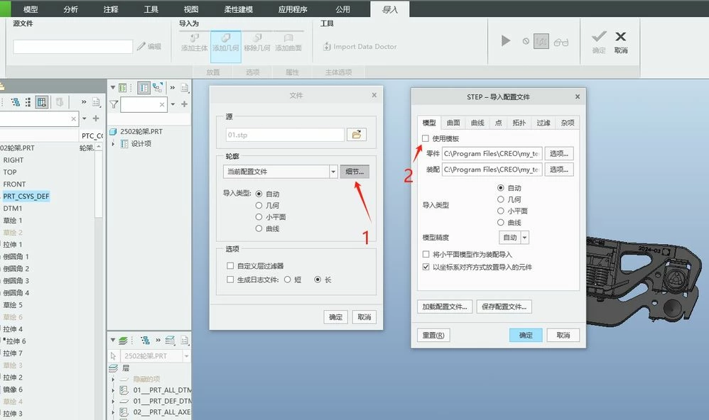

Have you set the import dialog to use a default template? It does not use your standard start part template.
Article - CS30943 - How to use a template part or assembly while importing different file formats like IGES/STEP in Creo Parametric
