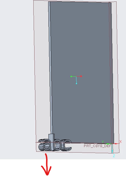

Part Text Vertical Protrusion
How to protrude image 1 text vertically as in image 2 drawing?
MikeBennett
Dec 18, 2025 7:18 PM UTC
Hi @Yogesh.T ,
According to CS63567, this cannot be done in a single text field in a sketch and multiple text fields should be used.
Hope this helps,
Michael

A discussion on somewhat the same topic from long ago (2016) initially asked by me. Doesn't seem like the capability of doing this exists yet, as far as I know.
https://community.ptc.com/t5/3D-Part-Assembly-Design/Vertical-text-creation/m-p/355053
Dec 23, 2025 11:46 AM UTC
This still doesn't exist. Back then on WF2 or 3 I had to create a pattern of letters for a dial. Did it by dimension patterning a group (pattern as a place holder), Unpatterning and then changing the values. Later on, created a parameter & relation for the instances. I forgot how I did it.
