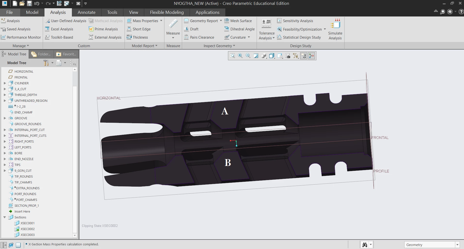

I have a fairly complicated region that I need the area of to verify the safety of that region but can't seem to find out how to just get the two parts of the cross sections area. Attached is a screenshot of the part, labeled " A " and " B " are the two areas that I need to know. The measurement tool doesn't let me get the area of cross sections and mass properties cross section analysis doesn't let my to get just a part of it. Is there a way to do this in CREO?

  • select the area (A+B is highlighted)
  • CTRL+C
  • CTRL+V
  • click Options tab, select Exclude surfaces and Fill holes option, select contour of unwanted part
  • finish Copy feature
  • select new surface and measure it

To measure a section you must select the plane that cuts the part, then go to the Analysys tab and select the drop-down menu in Mass Properties and select the option X-section Mass Properities. This option measures the area of the part at the intersection with the plane anywhere in the part.
