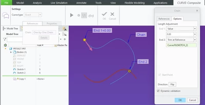

So I have those 5 curves, and I want to make a surface (with surface menu or boundary blend, either way is fine). Problem is surface is not responding to select those 5 curves together, and rightly so due to their positions and they "estimated-by-my-eye" result that it would come out.
The closest thing to a solution is to take 2 of those 5 curves, and then use the rest as guides. Which works up to a point BUT...
5 curves are not full ones. 3 of the 5, are partial ones, I want to select them from up to a point. Also it is worth noting that those curves are all boundaries of the desired surface.
1. I connect 2 surfaces. One is partial, one is full curve. All fine so far.
2. I add one partial one at the left boundary. Still fine, surface closes in to the desired shape.
3. I have to add 2 curves, as right boundary for the right side. One of which is also partial. Either way, partial or no partial, CREO does not accept 2 curves to be recognised as one and added as boundary or guide curve.
(all connections and points are snapped properly)
Any idea?
Image for better demonstration:
Red is not used and is left out of the partial loop.
Green is selected to create the surface.
Blue is the  guide curves.
I keep the same number for the same curve.
I change the letter when something is left out, from selection. It is still the same curve though.
Thanks in advance.

Jun 2, 2023 12:01 PM UTC
please upload your model.
Note: It seems to me that some curves have tangent connection with others. I guess that is not allowed.

Jun 2, 2023 1:05 PM UTC
Tangent curves do need to be part of the same side of the surface.
To use 4a with 3 you will need to make a copy of 4 trimmed to 3 first.

What if I want to use 4 for something else so I cannot trim it off? Is there any way to duplicate 4 in place, trim it to 3 as suggested? Also after trimming 4 to 3, can I connect 3 and 4? I don't think I have seen such commands in creo.

kdirth21-Topaz IAnswer
Jun 6, 2023 12:54 PM UTC
Making the trimmed copy leaves the original in place.
  • Select the original
  • Ctrl+C
  • Ctrl+V
  • Select References drop down then Details
  • Select Options tab
  • Select drop down for end you wish to trim, select Trim at Reference and select object to trim at.
  •  Complete feature.
