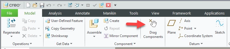

I think some visual components or data examples will help the community to better understand your post and to help address the inconsistencies in the constraints.  Surely this is more complicated than cube-cube 3 coincidents or peg in hole insert-coincident-assumed align.  The component 3D dragger (3 axes/planes/rotations) should help to indicate any underconstrained components during assembly.

Creo is most likely constraining exactly as the user has instructed via the UI. As mentioned previously assumptions can be unpredictable (e.g. normal directions get flipped). Use the drag components options and look at the dragger in the graphics window, it will indicate what DOF remains unconstrained for any given constraint set.
