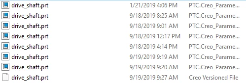

I realized another detail that may be related, I'm not sure. Most times when I save a part, it saves as seen in the image attached below. When I go to open that part (the last one, without the Creo icon) I always have to select Creo Parametric as the program to open the file. Could this be related in any way?

You may want to turn on your filename extension to make it easier to find the "latest" one.

Thanks about the file extensions, that is a helpful tip
