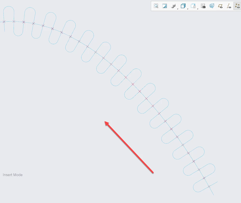

Hi All,
I need to create a pattern like this...

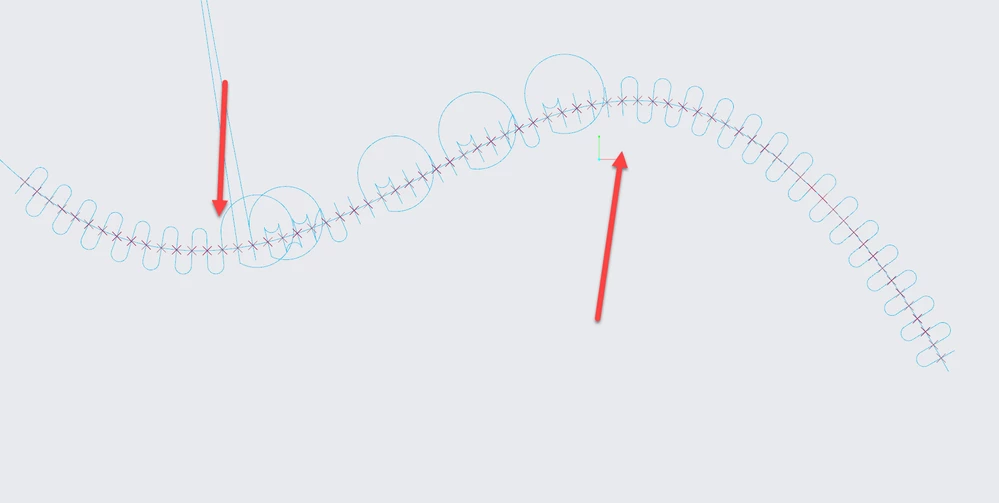

I've built it about 10 differnt ways, but it seems to always fail on the inflection point here
I'm sure it something to do with normals being flipped for the curve as it goes over the apex. (start points on curve flipping from botttom to top - if you copy and paste the middle curve from the first group in the patter and conpare the direction start point to one from a failed group you can see what I'm talking about )

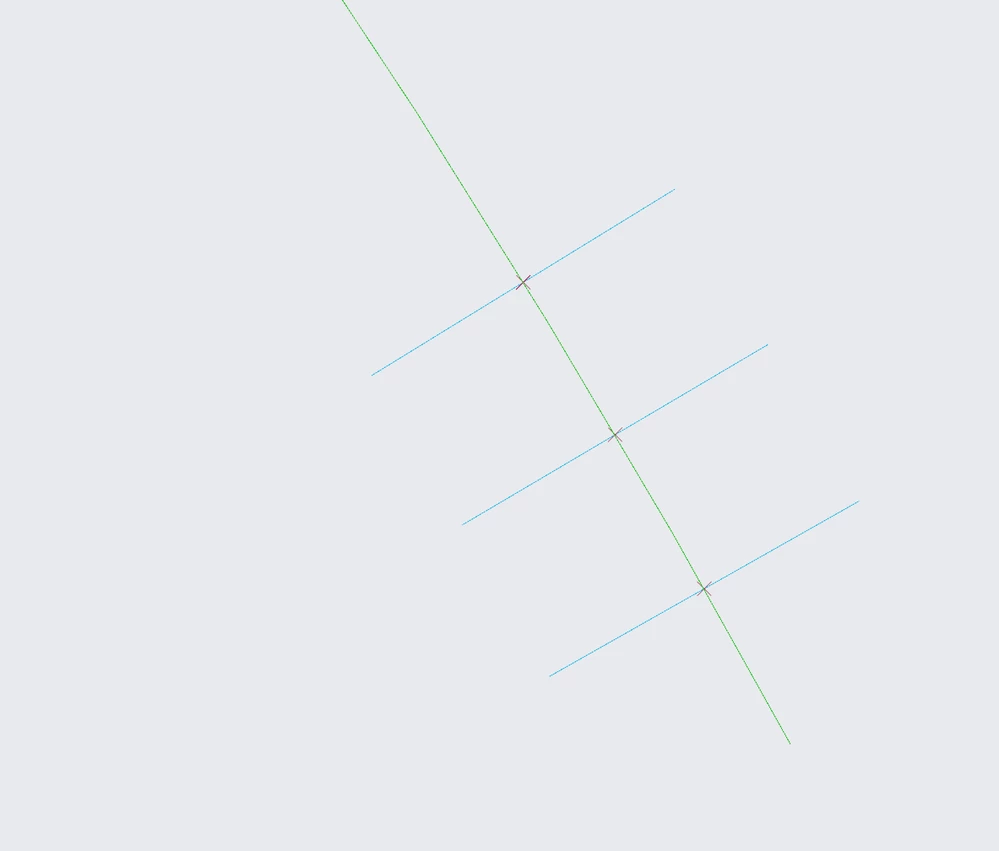

basically what I've done is create a spline, place a point at a real distance of say 5mm from start, another at 10mm and another at 15mm. (I tried patterning this 3 times to get 3 points at 5, 10 and 15 for construction but then Creo was complaining about patterning that)

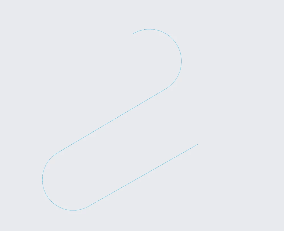

I then constcted 3 curves that were normal to the spline and through each point
then a new sketch over that to add rounds
then I pattern that construction and final sketch to give me the geom I need.
I did maybe 10 variations of this, diferent ways of constructing the same geom but they al fail on inflection where  the arcs on the last sketch jump to the opposite end
I've tried also constructing offsets and using edge and trimming to get the underlying geom to add full rounds afterwards but it just fails at inflection again.
If I unpattern it, and go to where it fails, a simple sketch update references solves it..

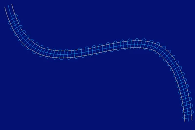

Yea - this is a bit of a frustration.   Often I find that if you keep things more local you can get better results.  I noticed your patterned used three reference offsets... this should be done by one.  I used a perimeter dimension to simulate the offset distances that you were using along the point on curve.  You get the same distances for the resulting points from the center of the reference - then built from center point of the pattern out.

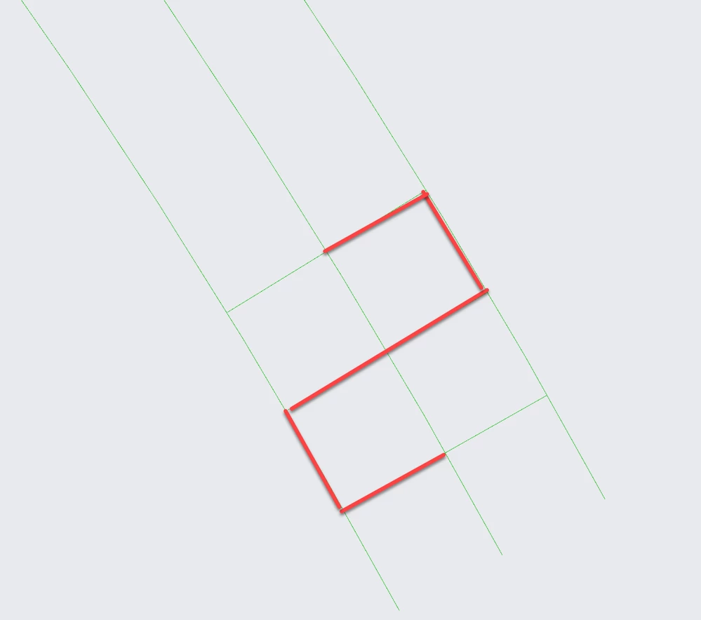

Another problem is the tangency of the arcs... they will never be able to be perfectly tangent to the normals under a spline trajectory.   To "hack" this - use a spline and tangency to mimic the arc tangency - this assumes that your goal is to have the tangency on the outer spline offsets  -- which are always varying their gap distance along the trajectory.
IF you do not need the tangency for the arcs to be on the spline - then the length of the normal curves would have to be allowed to extend beyond the offset splines (in or out depending on the inflection).
This is what my updated version looks like.
Attached is the file -- hope this helps.

The rad tangency is easy solve with a reference pattern and a round feature, I only put it in the sketch after about  my 5th attempt to join the normal lines.
