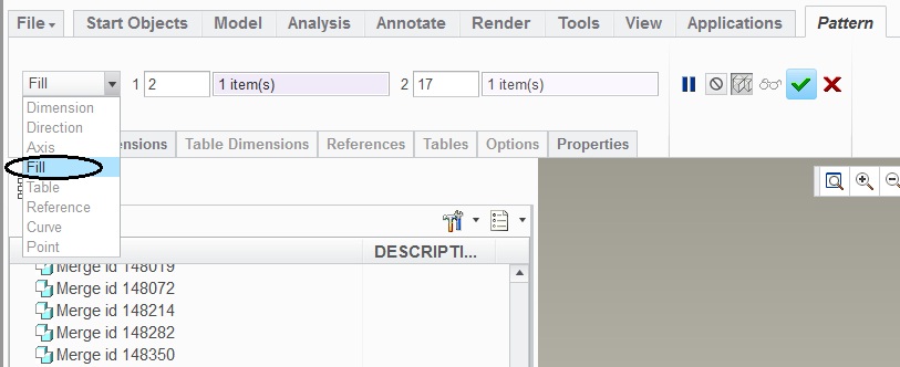

I have used dimensional pattern in Merge part. I have used more than 10 patterns in merge part, Some pattern is from table & others are from dimensional. Somehow When I need to redefine pattern type from dimensional to table it only shows fill type pattern. Other patterns are not highlighted. What should I do?

Dear Mr Amit,
I have made fabricated assembly & from that I have made merge part. In merge part I need to add some machining (Extrude feature) & number of tappings ( Group of Hole & Cosmetic Feature).  I have use approx 20 patterns for tapping. Types of pattern are dimension & table. Now my problem is when I need to change pattern from dimension type to table type, It shows fill type pattern only. Now I am trying to edit the pattern but it is not changing the pattern type. Also my all other pattern are also shows fill type pattern as per attached snap.
This pattern is made from dimension but it shows fill type pattern. Please help.
Pritesh

Hi Pritesh,
Would it be possible to upload the assembly for further investigation?  Otherwise, if you have a SCN, then I would recommend opening a case with Tech Support, to have the issue investigated further.
