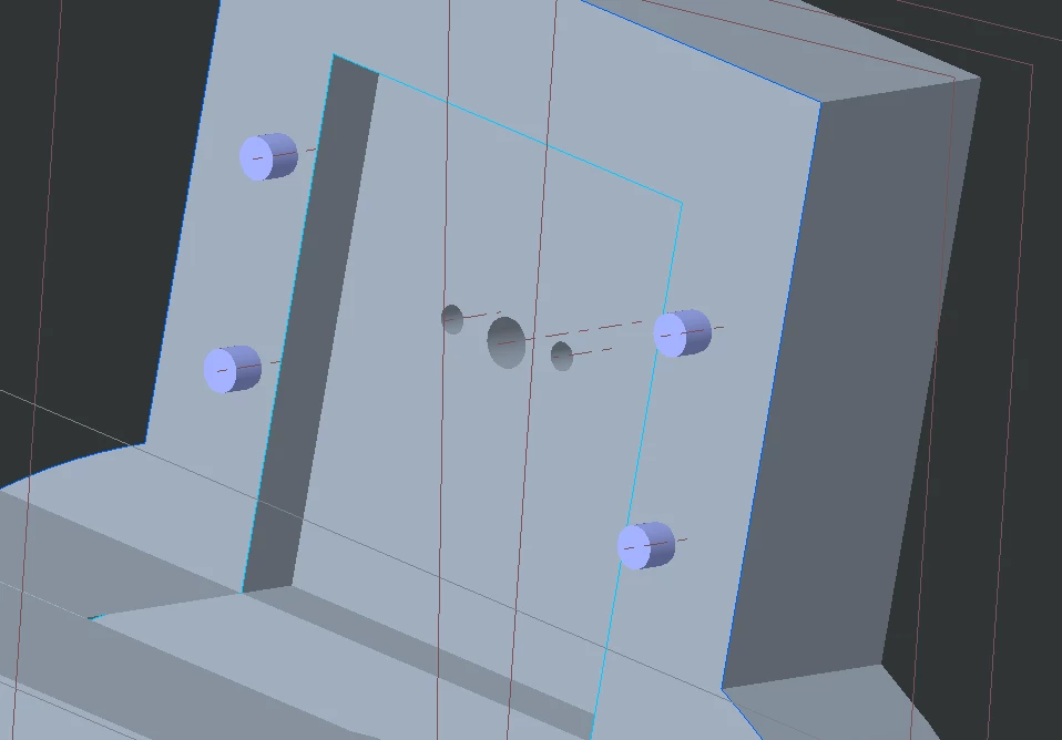

I am trying to generate a hole geometry feature that is rotated angularly around a specified central axis. When I do this operation, the resulting hole features are displayed, but they are highlighted in blue and do not appear as extrusions into the part. Any suggestion on how I can correct this? (The initial hole geometry was made using a singular place hole reflected about two planes).

I guess you created 4 "holes" using Freestyle feature. Freestyle feature = surface geometry.
Suggestion: Create 4 "holes" using Hole feature -OR- Extrude feature -OR- Revolve feature.

Have you tried the Geometry Pattern option..
It shouldn't be in surface..

Looks like threaded holes were placed in the wrong direction.
I think you need to "flip" the placement?
(in edit-definition)
