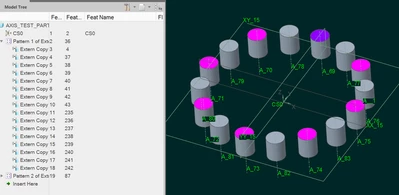

May 23, 2022
I think the answer is "it depends".  This was done in Creo4 after the definition of the pattern in the skeleton model was changed from "axis" type to "dimension" type.  The system warned that the pattern will be rebuilt so children might fail.  I ignored this message and then put a relation on the increment dimension to create the additional 8 instances (basically, relation said that increment is 45° except the 9th instance should be 22.5°)  In my test part, the original instances were colored purple, after updating, then the new instances were placed without any interaction:
Now, even if this is possible to do this hack in Wildfire 4, the question is - is it a good idea?
