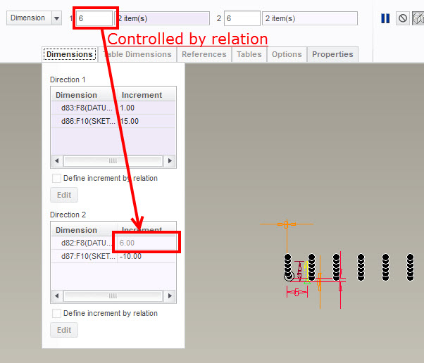

I am trying to find a way to create a grid of sequential numbers, eg.
1 2 3 4
5 6 7 8
It doesn't matter if its done in a model, assembly, or sketch as long as it counts from 1 to what ever number I choose.
It doesn't matter if its geometry or cosmetic as long as it shows up where it should be located in the drawing. (No linguistic note tricks)
This is for engraving location numbers on a flat plate. Surely someone has run into this before and has work around.
If this is a repeat question please direct me to the answer as I was unable to find it.
Thanks for any help in advance.
rcookAnswer
Sep 24, 2015 9:38 PM UTC
One more small refinement. I added a relation to tie the increment of the rows to the number of columns. As it was, you had to manually match the two. Now all you need to do is change the number of pattern instances to set how many rows/columns you want. Everything else follows (after a regen).

If you cannot read it here is the formula I used as well.
foo=length:FID_1_COUNT + (10*(length:FID_10_COUNT - 1))

I just used your video and it worked like a charm. However, I need to have one pattern as you show it 1-50 and then another pattern 51-100. How do I start the second pattern.
Eric
Jun 21, 2017 5:55 AM UTC
simply repeat the same procedure once again using following relation
foo=length:FID_1_COUNT + (10*(length:FID_10_COUNT - 1)) + 50
