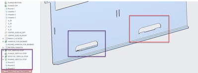

when i try to pattern some features together, the result is not as expected (see picture).
i do not know where the problem is. "normal" pattern did not work, only geometry pattern.
first grouping the feature did not help as well..
creo file is attached

The PLANNER_VERTICAL_STOP feature has the same issue.  Change it to a 0° flat. with end offsets.

Geometry patterns are not possible in sheetmetal.  See CS277485
The external references seem to be preventing a normal pattern.  You will need to remove the external references or pattern each feature separately with a feature pattern.

The sketches in the cut and flange have external references.
