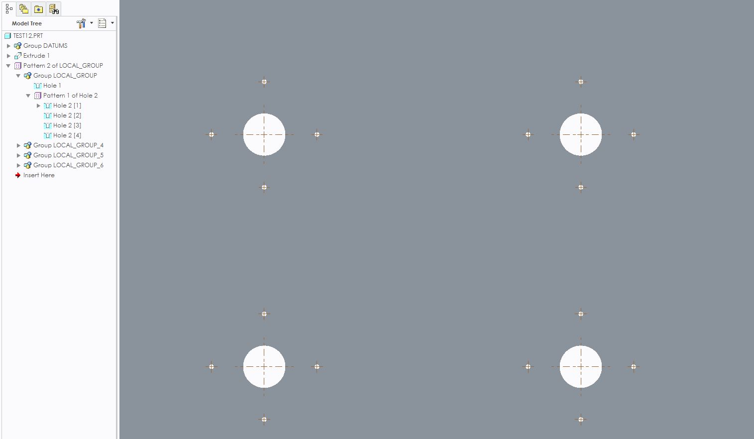

I created a set of tapped holes that have external references and are located about an extruded hole that also has external references. I have 4 extruded holes that need these tapped holes around them. Right now all I can think to do is measure the distances between the extruded holes and then use a distance pattern to get my tapped holes in the correct place. But if i do it this way then if i move the extruded hole then my set of tapped holes will not be in the right place in the other locations. I'm thinking there is a better way?
The picture attached shows the 4 holes I need to pattern.

This is a thought, but not very elegant. If you draw a Sketch center to center of your extrudes, put a .5 point on the sketch so it stays centered and then a plane on the point, you should be able to mirror the pattern over. And then same thing again in the other direction.
Again, not elegant. But should retain parametrics.

Even with the center hole as an external reference, you can locate the 4 threaded holes based on the axis of the center hole. Create one threaded hole, referenced within the part, select Diameter in the hole dialog, and select an axis and a datum plane (you will need to make a datum plane in the center hole) for an angle reference.
Next, pattern the new threaded hole about the center hole's axis. With the right drawing config set, this will also generate a bolt circle centerline in the drawing.

I would create the initial extruded holes with a pattern (which I will refer to as pattern1). Next create the pattern of tapped holes around the original (or first) hole in pattern1 (which I will refer to as pattern2). Now pattern pattern2, which should automatically be a reference pattern (which I will refer to as pattern 3). So pattern3 will be a nested pattern containing pattern2. If you change the dimensions in pattern1, the tapped hole pattern should follow it around.
I hope that makes sense...

You also might try a point pattern by just creating the the first hole of the four hole pattern, create a sketch of points for the required locations with reference to the the four larger holes, and pattern using the point sketch.
July 14, 2014
We can have a group pattern. Create the extrude hole first and then pattern the tapped hole around the first hole. Group this set and then pattern the group with x and y direction. (Refer to the model enclosed for details)
