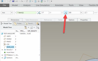

pattern with axis to foll certain angle with any amount of holes
I am using Creo Parametric - Release 7.0 (connected) 7.0 7.0.4.0
pattern using axis to fill up certain angle is gray out
how to fill up 300 degrees with 17 holes?
    szycha63Answer
    Dec 6, 2021 4:19 PM UTC
    this symbol is gray out I can not use it
    that's why I did open this case

    To change to fill up, click the angle button shown below
    szycha631-VisitorAuthor
    Dec 3, 2021 9:01 PM UTC
    So in order to create this pattern You HAVE TO CREATE AXIS I did not think about that but I did use axis from the part - wow

    By far, they easiest way is to use an Axis pattern which requires an axis at the center of rotation. 99% of the usages are cylindrical parts that are easy. But, there are some usages that make the axis pattern super useful and all I have to do is create an axis where I need it and I can pattern anything around that random axis location. It makes for a very useful feature.
