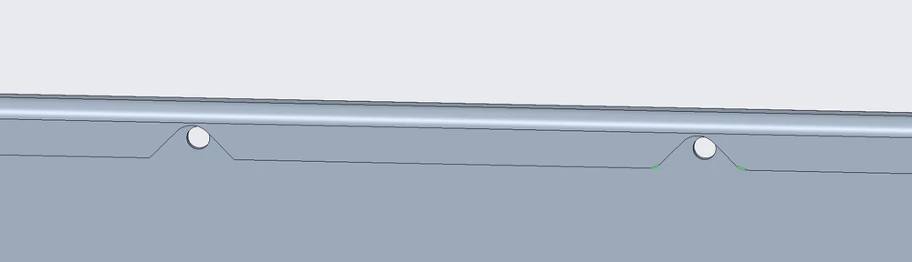

I have a hole pattern and created some access cuts on a sheet metal part (see picture below).  I rounded/filleted the edges (highlighted in green).  The cut feature patterned easy enough following the hole pattern, but I cannot pattern the rounds (greyed out).
Outside of adding the fillets to the cutout sketch, is there a way to pattern this?  Selecting all of the patterned edges for the round feature seems tedious, and I would guess there would be issues if the hole quantity changed.

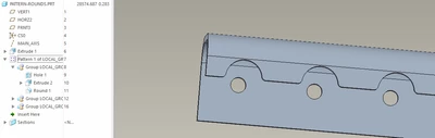

I don't know about this specific use case but if I want to pattern rounds with features, I typically will get one area done completely, group those features, then pattern the group.

I was excited to try out your solution, but unfortunately I got regeneration errors.  I tried grouping the round with the cut 1st, and then I removed the original hole pattern and tried grouping all 3 features in 1 pattern, same error.  ☹️

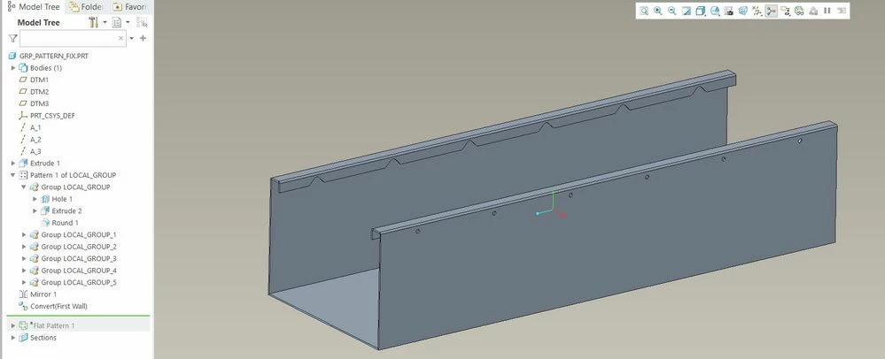

Grouping will work in most cases like this as @StephenW  posted. The most likely issue is that your references are being lost when patterning. Without inspecting the features, it is hard to tell. If you post the model or a similar one with your grouping of the features someone may be able to troubleshoot it.
I have posted a model for reference (Creo 4) that utilizes a pattern scheme similar to what you want. In this test case a group is not used intentionally for debugging purposes. So you will see 3 patterns rather than one pattern of a group. Sometimes this is necessary depending on the references needed and reference patterns are used for the subsequent patterns.
It is also using intent references, but it should give you an idea of how to handle your design intent. The intent refs are used to make the pattern much more flexible so it will turn the corner on the shape. You can demonstrate this by increasing the # of instances in pattern 1 from 5 to 6 instances.

As I had suspected the round edge references are failing in your model. The issue is with the intent edges of the rounds (.125 R) on the cut. In your part, the intent edges as defined internally by Creo are not playing nicely with the pattern. You have no direct control over that. Sheetmetal parts have historically not been compatible with core modeling features in some cases.
I have posted a part that does pattern the geometry as you desire and uses the mirror of the geometry as you intend. I created a solid part and then converted it to sheet metal. This represents one way to generate the model with the geometry and pattern you specified. I hacked this together fast to test it.
The model is Creo 7. Model tree shown in case you don't have Creo 7.
