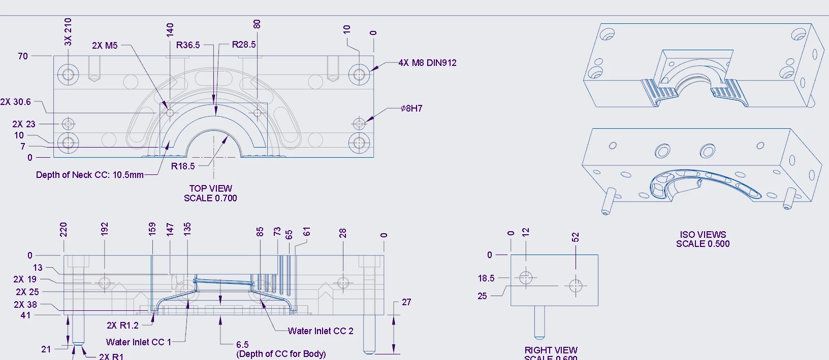

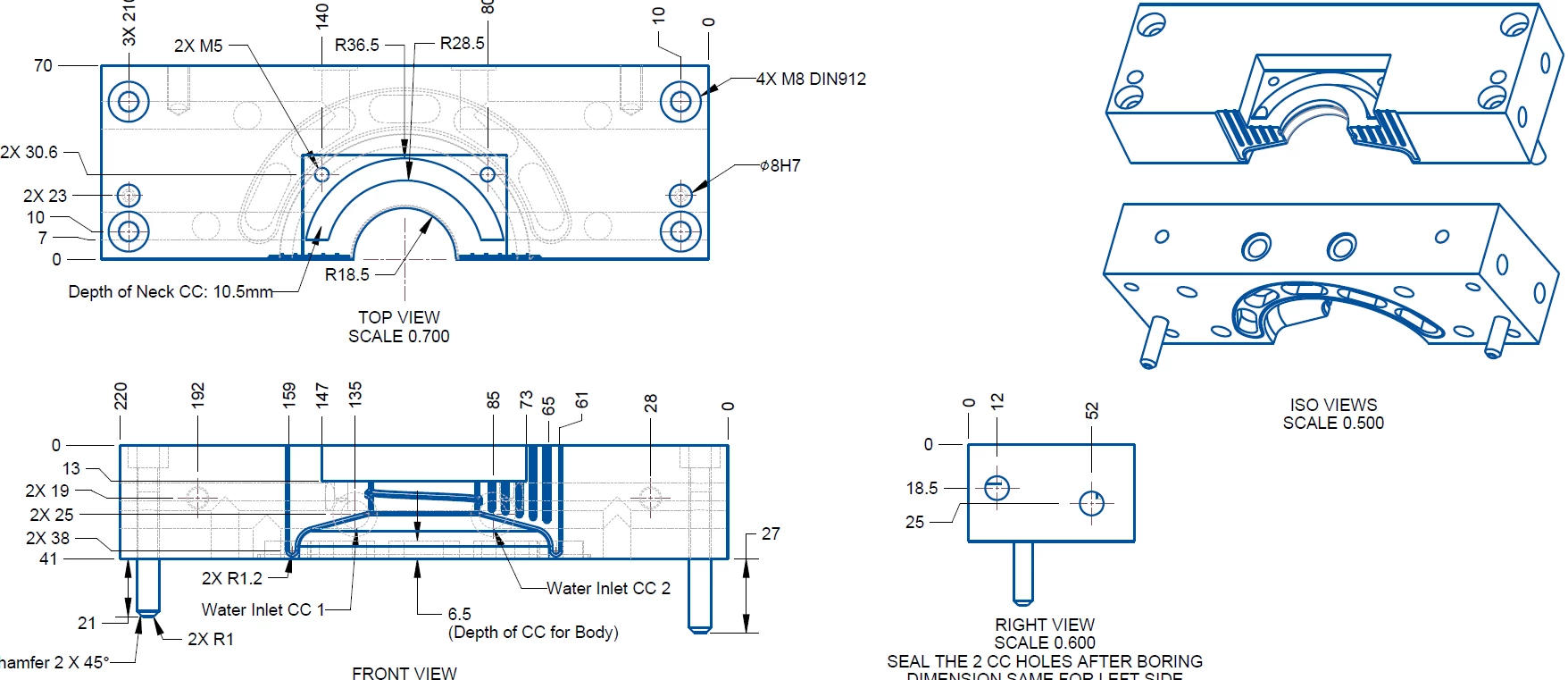

When i export, my drawings are shown like this
but in the creo drawing the lines are thinner, i can clearly see the slots or grooves that I have created.

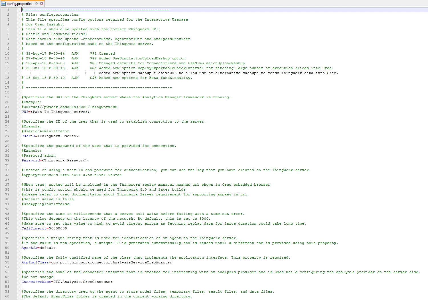

and also is this the config file that I’m supposed to add the path?

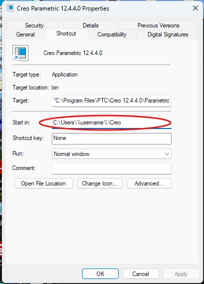

The correct file should be config.pro in you start directory.

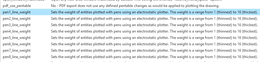

By default, Creo uses ISO system for line thickness. play with these settings.

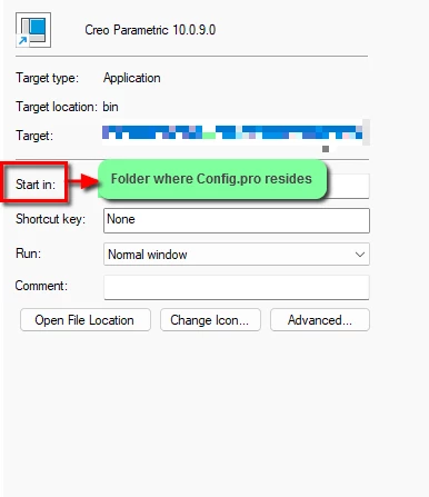

Also the settings are saved in config.pro.
Ensure that the modified config.pro resides in the Start in folder.

Search for pen tables configs on the site.  You have to make your own pen table and you can modify how everything looks
