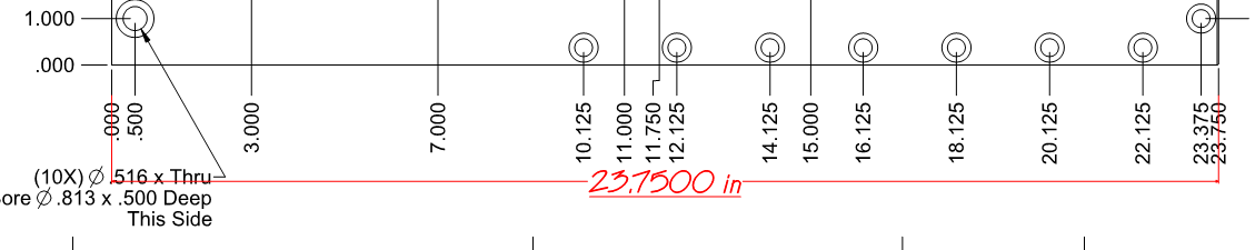

I have used BlueBeam Revu for the past several years and I like it. They do have a free version with limited functionality that I believe can also measure.
http://www.bluebeam.com/
The picture shown above is a PDF generated by Creo 3.0. I used the Calibrate and Measure tools in BlueBeam Revu  to insert the dimension in red.
msteffke15-MoonstoneAuthor
December 16, 2016
Wow this Bluebeam looks really promising!    Calibration, precision, YES!!!  I will dig into it and see how it works with our processes, but so far its the best viewer I've ever seen.    Re-exporting the current PDF is not an option.  These are all being auto created by my toolkit, I could easy just create a dxf at the same time but I don't want to have two copies of exports to maintain.
