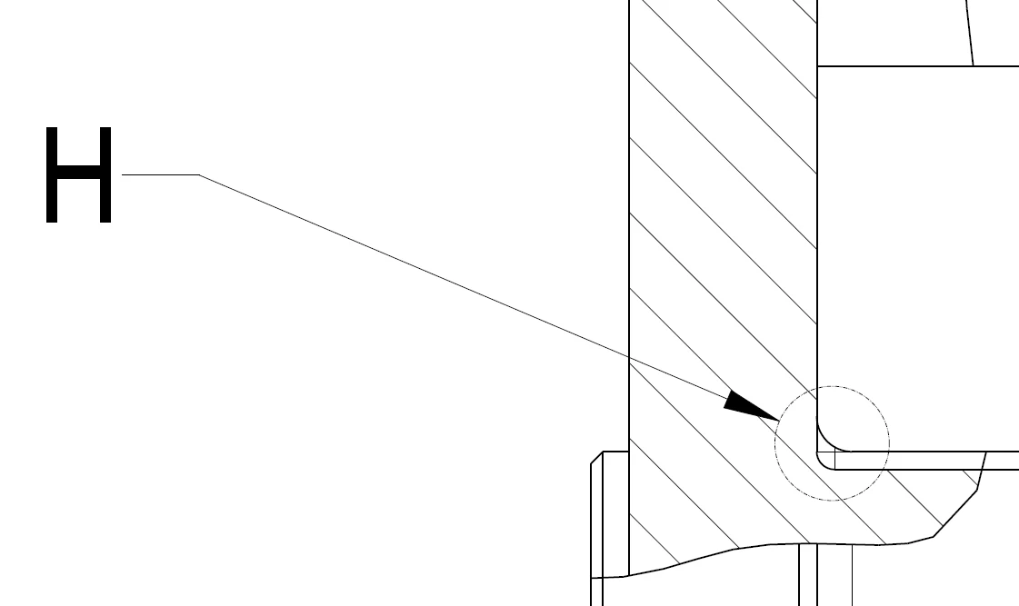

  2. i would like my Detail Circle to be properly spaced.  Some of the pen tables i've tried has the detail circle as super tight(basically a solid line when viewing in a PDF and on the drawing file itself)
    1. The attachment for this bullet point is zoomed in pretty close

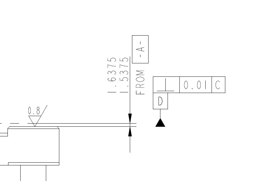

  3. The leader line of a Datum Feature Symbol(when it goes dashed for whatever reason) has to be viewable.  Half of the pen tables i've used it doesn't even register it(just a datum floating in space..)
  4. Another quirk is that the same pen table on my desktop computer doesn't output the same line styles as it does on my laptop(most notably the Datum Tag is missing its line on my laptop vs visible on my workstation)
