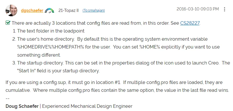

your config.pro must contain following options. Replace E:\users\creo7_parametric\pentable.pnt path with your path to pentable file.
use_8_plotter_pens yes
pen_table_file E:\users\creo7_parametric\pentable.pnt
pdf_use_pentable YES
You can edit config.pro outside of Creo using Notepad.
config.pro locations are explained in https://community.ptc.com/t5/System-Administration/How-to-change-default-config-file-location-in-creo/td-p/262083 discussion.
