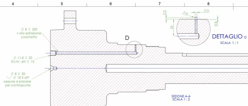

To assign DIFFERENT color to entities which belong to the same group, for ex. LETTER_COLOR which includes dimensions, notes, cross hatch, axes and many other things.
I want to reach the COLOR printing as below:
DIMENSIONS and NOTES: green
Then I use the following in the pentable:
pen 2 thickness .015 cm; color 0.4392 0.6588 0.3607; letter_color
Now, if I want AXES (CTRLFONT L L and CTRLFONT S L) to print in blue, I must assign a blue color (for example) to all the axes manually, and then use the following:
pen 8 thickness .018 cm; color 0.0 0.0 1.0; edge_highlite_color
For the CROSS SECTIONS, to assign RED color manually and then:
pen 4 thickness .018 cm;color 0.949 0.509 0.705; highlite_color

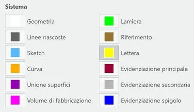

I mean, when specifying the color scheme in the System-Appearance configuration UI, there is this palette:
When it is exported to a .SCL file, the names are:

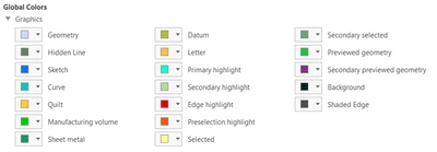

So then, you can assign a color to display on the screen for common elements - but from a reduced palette of 13 "Theme Colors":
Note the tooltip - values specified as of 0-255... and that selected is the "Datum" color.

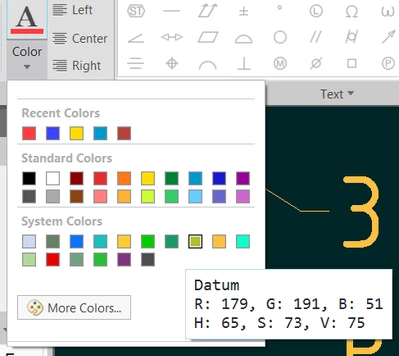

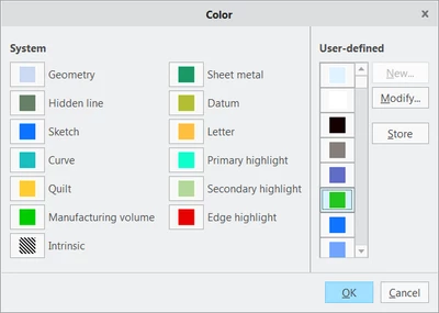

It is curious that when you use the "Format" menu in the ribbon, for example, to assign color to text, it seems you have 16 "system colors" to choose from:
So then in the pen table, you can assign a pen with is own color and linestyle - to use when printing all things assigned to a specific "system color", as per the list provided by @MartinHanak - which has 17 different names; I think they are same as the 17 system colors listed in this table from PTC:
Default pen assignments
But my head is already spinning at this time.  Which one from the configuration UI corresponds to "magenta_color", "half_tone_color", "drawing_color" to be specified in the pen table???

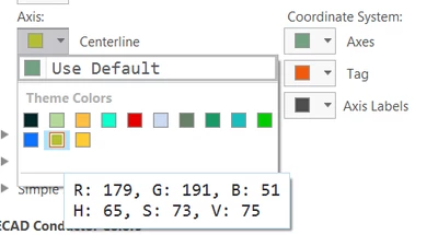

Anyway, if I want axes to print as blue, then I see two ways of doing it.  With reference to my color-scheme above (note use of the "Datum" color for drawing axis center lines - the default is I think is to use the "Letter" color):
1) in the pen table (.pnt) file, I add this line:
pen 9 thickness 0.006 in; color 0 0 1; datum_color;
(note: pens 1-8 do not have the ;datum_color tag)
so in this example, my axes, even though they are colored "greenish-brown" on my screen, will actually print out as blue.
or
2) I make the "Datum" color blue in the UI, and then in the pen table, I can remove the color override:
pen 9 thickness 0.006 in; datum_color;
