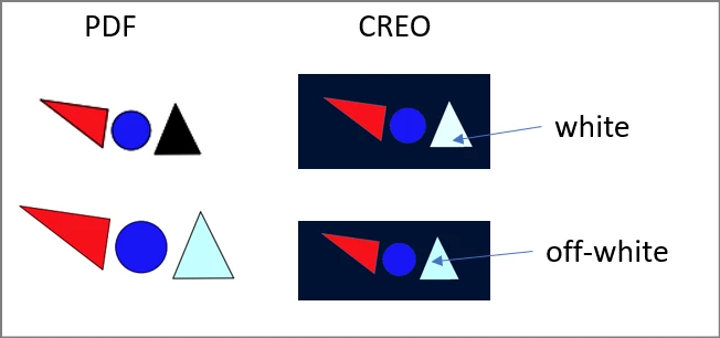

I want to create a symbol with 3 colors, Red, white and blue. I am using Creo 6.
I use a filled hatch pattern. When I make for blue and red, no problem, but the white are is printed in black. When I modify the white scale to a little less white, it pops up ok.
How to print fully white area?

according to https://www.ptc.com/en/support/article/CS248825 you have to set following config.pro option
intf2d_out_pdf_white_as_black no
Also pen definition related to your white color must not contain color keyword.

Jun 28, 2023 3:02 PM UTC
As usual, you are the GOAT.
Thank you so much.
