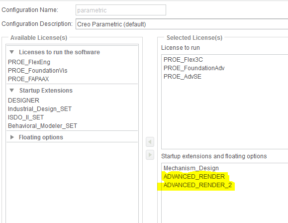

does anyone successfully run Photo-Realistic Rendering in Creo 4.0 F000???
When I press at button PR_Button.PNG no action happen???

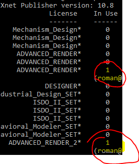

I tried with both advance renderer licenses I got and no positive results - only license visible consumption ;-(
is this a bug in this first F000 release of Creo 4.0?

The Photo-Realistic Rendering requires the Advanced Render III license.  This is a known issue and Tech Support has filed SPR 6327272 against the lack of a missing license message when attempting to access this function.
Refer to article CS253200 for additional information.  If you are unable to access the article, please first create an account here.
rsobecki14-AlexandriteAuthor
January 25, 2017
You are right - I can confirm this - thanks!
