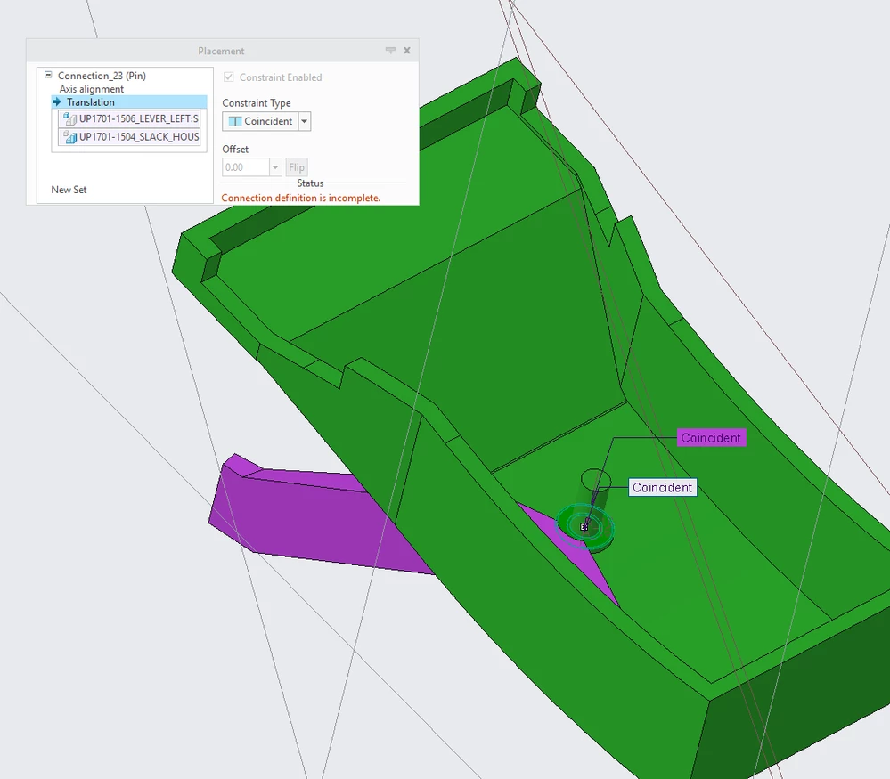

I am trying to connect two cylindrical shapes with a pin connection so one rotates around the other. I added the Axis alignment and the translation surfaces but Creo still says the connecition is incomplete. I am also not able the flip the connection. Can anyone tell me what is going on and how to fix this?
Kind regards,
Nine

Probably, because you leave 1 degree of mobility - which in itself is not a fixed object. If you exclude rotation around the axis - the part will be completely corrected.
I can be wrong, because now there is no way to check it.

The red part is constraint with a "Default" so it is completly fixed. Here I used the pin connection but I also tried a coincident on two axis and a coincident with two perpindicular (to those axis) surfaces, which didn't work either.
I added the files, in case someone has time to check them.
Kind regards,
Nine

I do not have Creo Parametric 4.0 M010 installed, therefore I used Creo Parametric 4.0 M030.
1.] I unzipped your file
2.] I renamed parts (the assembly needs this)
3.] I edited definition of up1701-1506_lever_left.prt
  • I set Pin constraint
  • I selected two axes
  • I selected two planar faces
  • pin connection was created successfully
  • to see references, edit definition again
4.] I edited definition of up1701-1507_lever_right.prt
See attached data.
October 23, 2017
maybe pin references are not correct.
Suggestion: Create test assembly containing two simple cylindrical parts and test pin connection creation.

My guess is you used datum features from another part to define the connection type. For example in a pin connection, you might have aligned the axis correctly but for the translation you probably picked the front plane from the main assembly (or another part) instead of the front plane of the specific part you are connecting to. So in this case the error kina makes sense since it only wants dependencies on the part you are connecting to. This was my issue at least.
Hope this helps.
