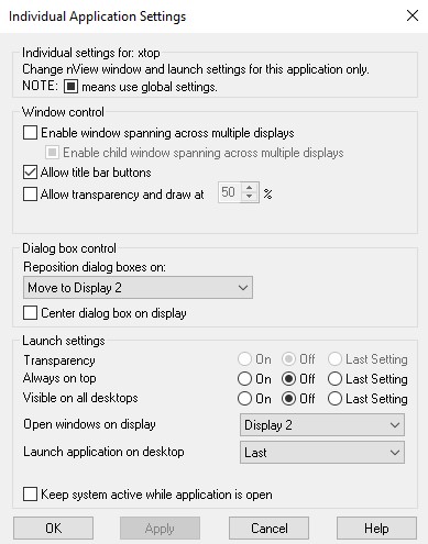

Jun 1, 2017 2:59 PM UTC
Since Creo is not a Windows app software and only interacts with Window thru xtop.exe there is two ways to accomplish this. Windows software remembers which monitor the software was on when it is closed and will open it to the same monitor.
  1. Open nView Desktop Manager, select Applications, Add, Browse, go to the following location below and select xtop.exe, Open, OK, select the Application the xtop application, Individual Settings and match the image below. Select OK and OK from the nView Desktop Manager to close the window.
    Downside: Creo is centered in the 2nd monitor, but every new Creo window opens on 2nd monitor
    C:\RTN\PTC\Creo 3.0\x64_creo3-m120\Creo 3.0\M120\Common Files\x86e_win64\obj
  2. Open nView Desktop Manager, Hotkeys Manager, expand Windows and Applications, select Move window to next display, then Add, place cursor in Hot Keystroke(cannot type in field, only keyboard selection) sect Alt key and Z, leave box unchecked, select OK, OK. Open Creo and select Alt button and Z. This moves Creo to the 2nd monitor
    Downside: Each new Creo window opens on primary monitor, must use Alt + Z to move to 2nd monitor
