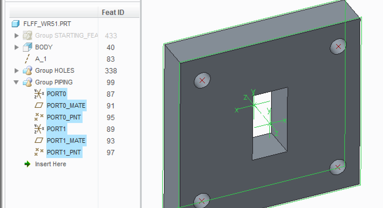

Can spec driven fittings and non-spec driven fittings be used interchangeably, or should different family tables be used for each design method?
I am aware that spec driven uses size and end type parameters on the fitting ports. Also, that non-spec driven lacks these parameters, but uses a datum point for axial alignment. I tried placing a datum point in a spec driven fitting and it produced a location offset.
May 16, 2017
Yes, these fittings can be used interchangeably in both non-spec driven and spec-driven piping, as long as they contain all the necessary inputs.
As you pointed out - since "non spec-driven" uses points (as well as CSYS features) to place the fitting int he pipeline, it will need point features.
However "spec-driven piping" uses CSYS features labeled PORT0 and PORT1, which, as you also pointed out, need parameters for the appropriate size and end type.
So I typically model a group of stand-alone features to look something like this:
When you created the datum point - did you create it "on" the PORT0 or PORT1 CSYS? Just curious - because that's how I like to model my piping features, and it typically works out fine.
Note: there is also the parameter for "Y_ECCENTRICITY" which enables the inlet and outlet ports to be placed offset from eachother instead of "inline".
Can you post a screenshot of what you are seeing? It would help me understand what you're seeing.
