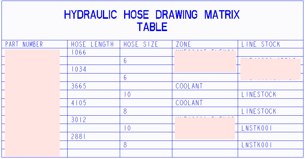

September 5, 2014
I have had a similar issue. I created a custom made repeat region using relations and filters to get rid of data that I do not want showing up. Then extract the data and export as .csv file and open it in excel.
