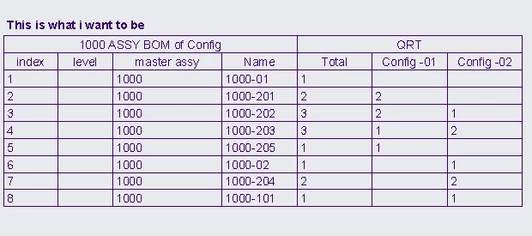

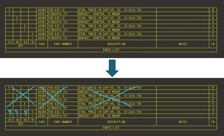

I would like to modify the bom as shown in the picture below.
I tried to find as similar cases as possible, but I think my skills are lacking.
I would like to change it like the attached picture.
Is that possible? and how?
Thank you for helping me, despite my shortcomings.
(creo 9.0.4)

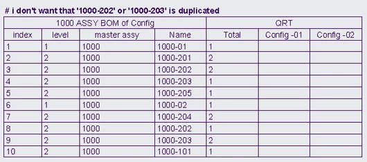

Although it is different from the photo in the question,
I have attached a file describing the problem I am experiencing and the direction I want to be.
PLZ i really need it.
Thanks for your help.
