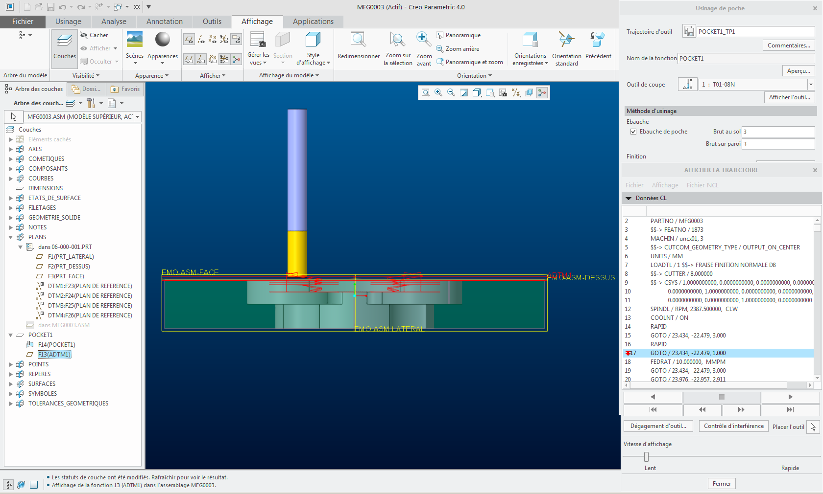

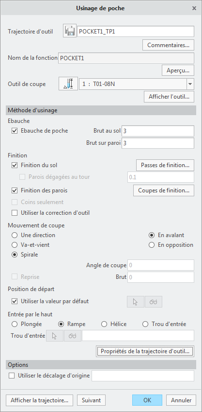

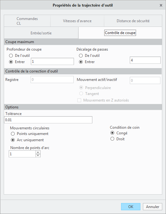

I created a pocket with pocket expert machinist feature.

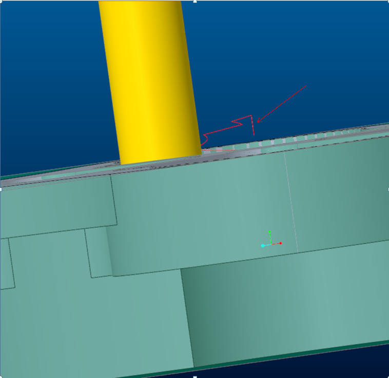

And i saw a issue with the fisrt approach motion : the tool plunge under the retract plane, up to the retract plan and start the ramp.
Somebody can help me, please.
Thank.
cdurand-31-VisitorAuthor
March 1, 2017

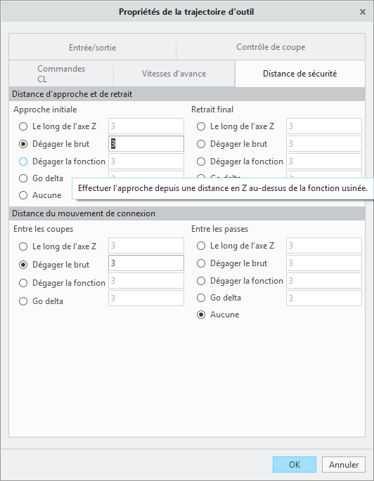

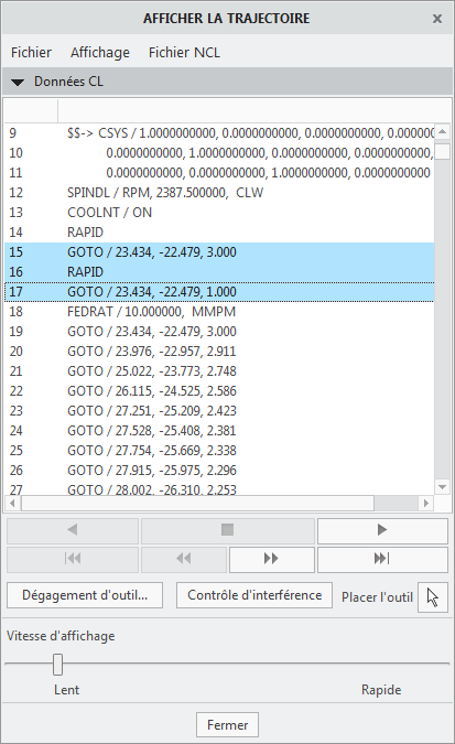

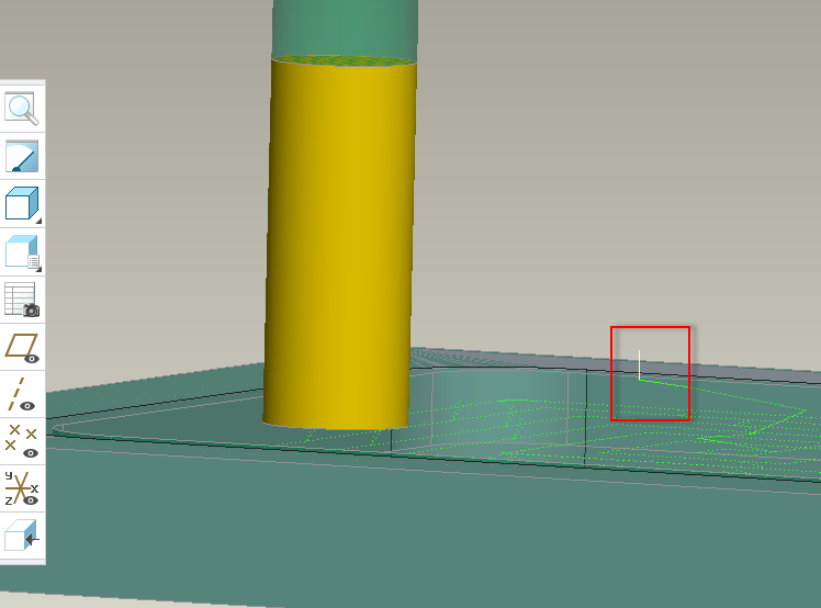

I investigated with my problem : when i activate approach distance (e.i 3 mm from the workpiece), creo add new line in CL file:
15 GOTO / 23.434,-22.479,3.00 -> OK approach
16 RAPID
17 GOTO / 23.434,-22.479,1.00 -> NOK, line add with out reason ....

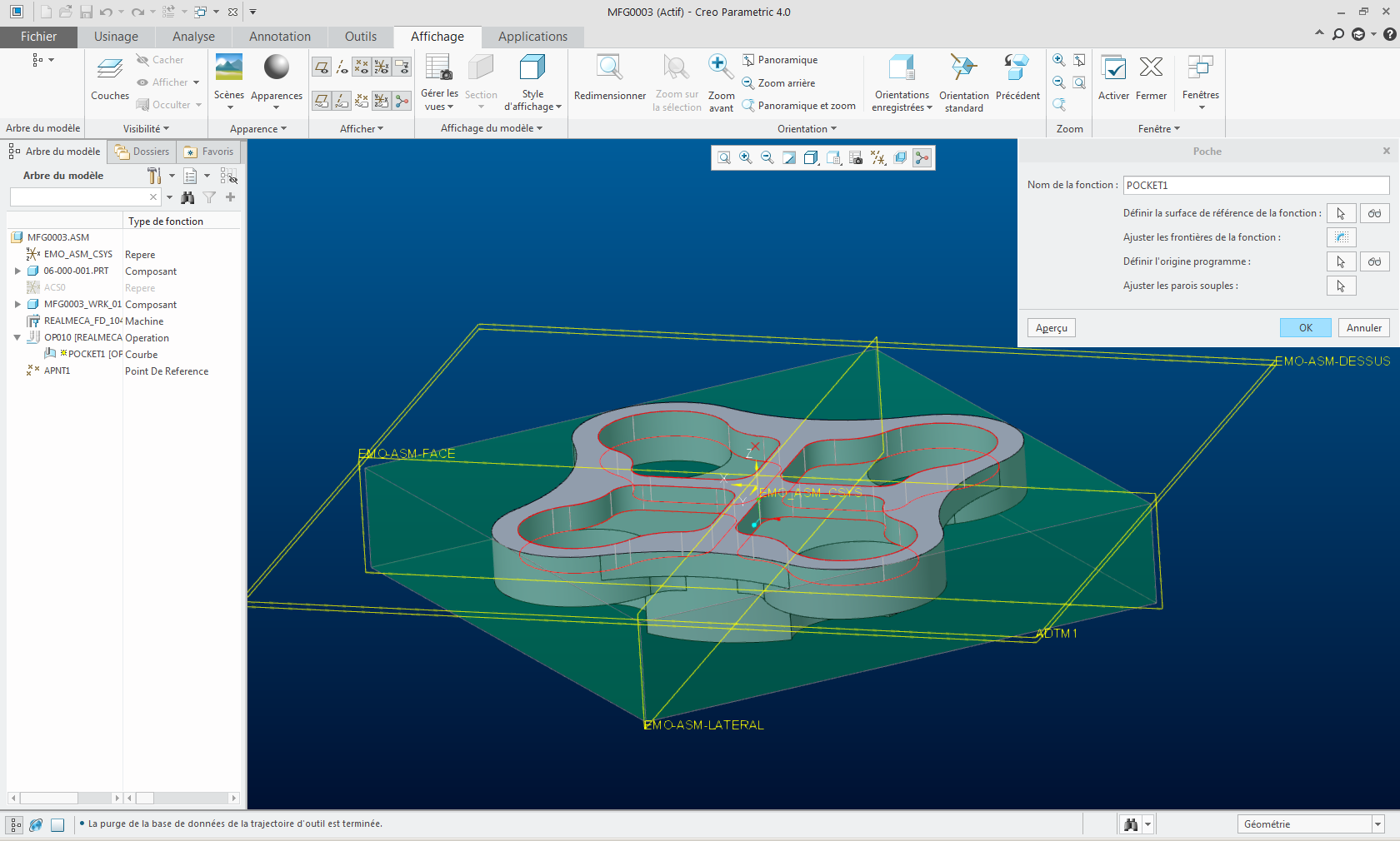

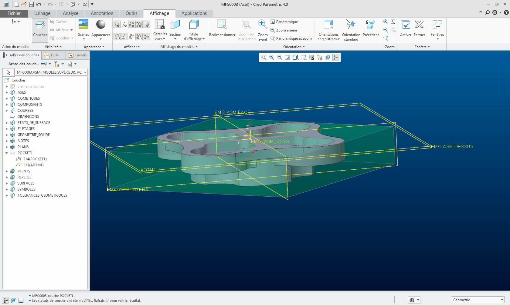

When the pocket is created, the top of the feature stop to a datum plane created automatiquely by creo (ADTM1 in the picture).
But it's impossible to control the height of this plane
In the CL file, creo create a approach correctly and after it create a extra plunge to this plane.
I don't find any matter to control this plane or to suppress this anormaly motion (with ramp entry).
I think this motion is very dangerous for tool because it product in rapid.
If the real stock is too big, the tool can enter in collision with it ....
Help me please !!!!!!

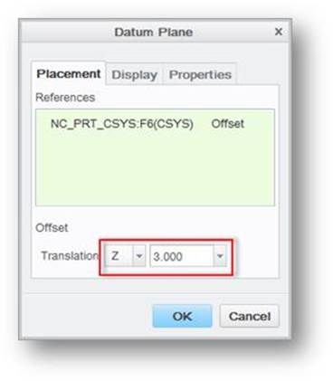

Hello Christ,
I found the root cause of your question. Please edit your “ADTM1” plan value height than 3mm then this problem has been solved.
Have a good day!!
