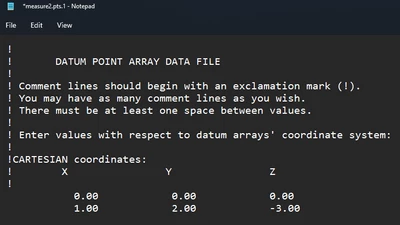

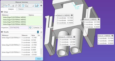

I would suggest measuring all of the points with reference to the coordinate system, save a file, modify the file into a points file and importing.
Select all points and select csys as the projection reference.
Press the info button kdirth_1-1676996515213.png and save information window to disk.
Rename file to *.pts.1.
Edit file to the pts file format.
Select Import button in Datum Point window.
