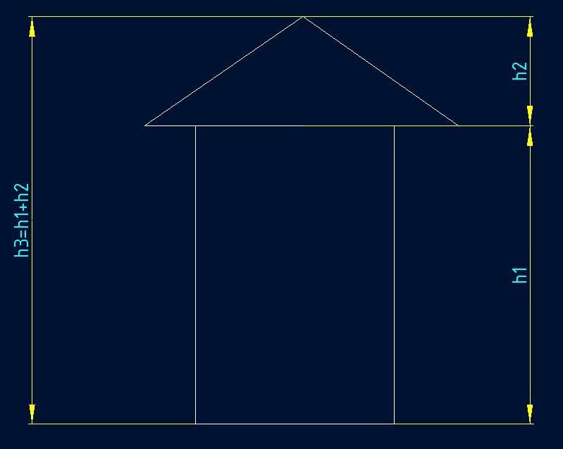

e.g. i got a house as drawing model and want to measure length h3 (thus h3 = h1 + h2). Creo is returning the absolute value... e.g. h3 = 100 but I would like to get "h3 = h1 + h2".

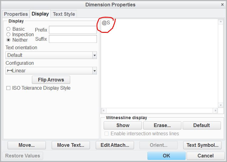

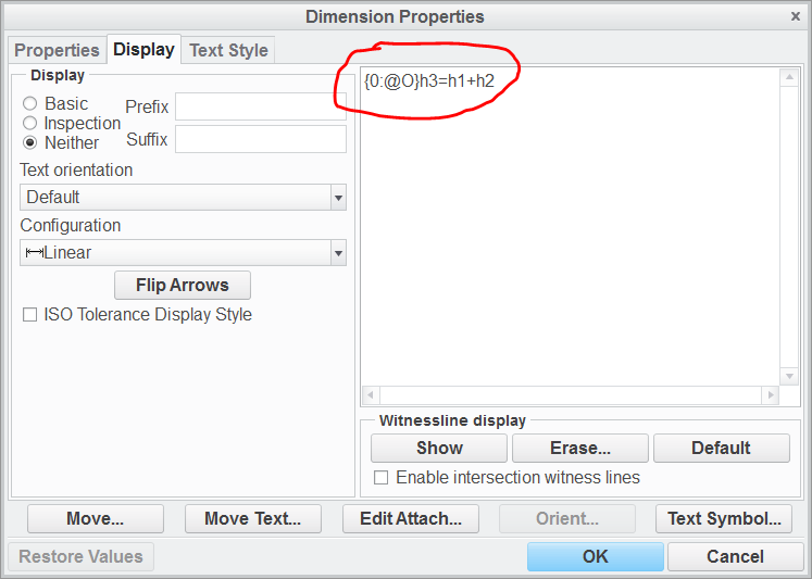

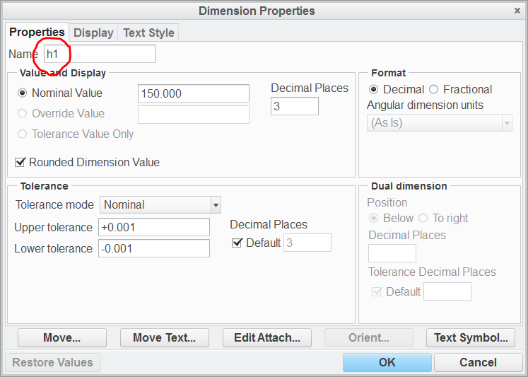

in Creo 2.0 you can get this result:
Dimensions on the right side are model dimension, which were renamed. When you display their properties, you will get:
Dimension on the left side is drawing dimension. When you display its properties, you will get:
Model & drawing is also attached.

all changes marked by red "ovals" were done manually.
