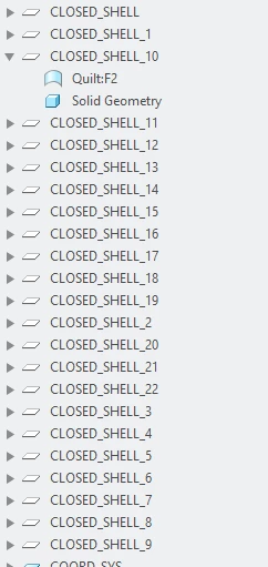

I've just run into the same issue, although from another angle.
I have some models in which certain parts came in as .igs imports. Those imports have some weird layers, on which all of their geometry resides. I wish to reproduce this sort of imports but I can not. Anytime I import a file, be it .igs or .step only basic layers are being created and the geometry is imported in the intended way.
I would like to know how can I import a model and have it put on shell or other layers.

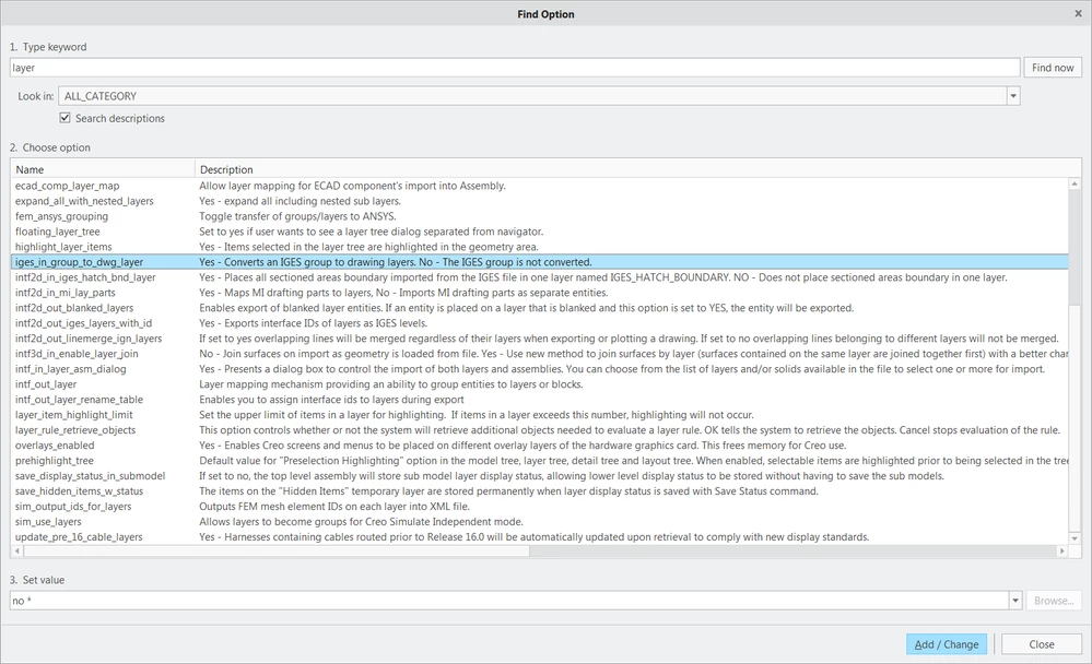

Two guesses come to mind:
1) create an import profile profile which specifies template part which has some kind layer scheme (default layers, or layers with rules?)  When bringing in the IGES data, maybe the entities will be autoplaced on the layers?
2) try various config.pro settings intf* and those related to layers, e.g.:
Feb 15, 2022 7:54 PM UTC
Thanks for taking a shot at answering this mystifying question 🙂
I've spent some time trying different settings when it comes to importing some random geometry, none has worked out. I'll try your 2nd suggestion tomorrow, although I think it exists as an option at import window, which I tried already.
Those layers as you can see have sequential names and each contains the same two items - a quilt and a solid. Maybe that rings a bell to someone?
