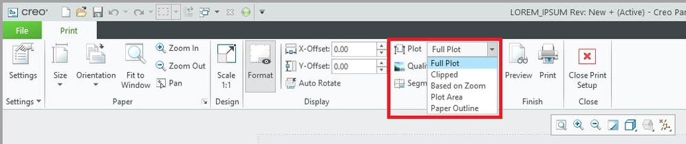

Are you messing with the pen table file?
Take a look at this setting:

I have not adjusted the pen table just the pcf. Changed to full plot and still just prints the bottom left.
