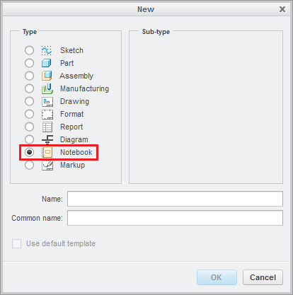

what are these pro/notebooks, mathCAD notebooks?
February 16, 2017
Think of them like drawings but with both parameters AND relations, and with the ability to link their parameters to the same parameters in other models (drive the model from the notebook.)  They used to be called layouts buy now they are called notebooks (even though they still have the .lay extension.)  They can only be created if you have the Advanced Assembly Extension.  You can read more about them here:  http://support.ptc.com/help/creo/creo_pma/usascii/assembly/asm/asm_three_sub/About_Notebooks.html#
