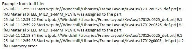

But if we are in a session linked to PDMLink, the program will not regenerate back in successfully, Pro/E steadily increases memory use until it runs out of RAM & bails out with a memory error (Win XP 32 bit machine with 3Gb switch enabled).
Looking at the trail file, Pro/E is assigning or reassigning a material to every lower level component in the assembly in turn and keeping them in session during the regeneration process until a memory error occurs.
We also tried editing the program and regenerating the changes on a Win7 64bit machine with 12Gb RAM and while it did not bail out with a memory error, we aborted after 30 minutes as the regeneration had not been completed and the user needed his machine back.
We raised this with PTC a couple of weeks ago and have escalated it, but their response back this morning confirms that they have no idea what is causing it and how to fix it.
I have attached an exerpt from the trail file.
