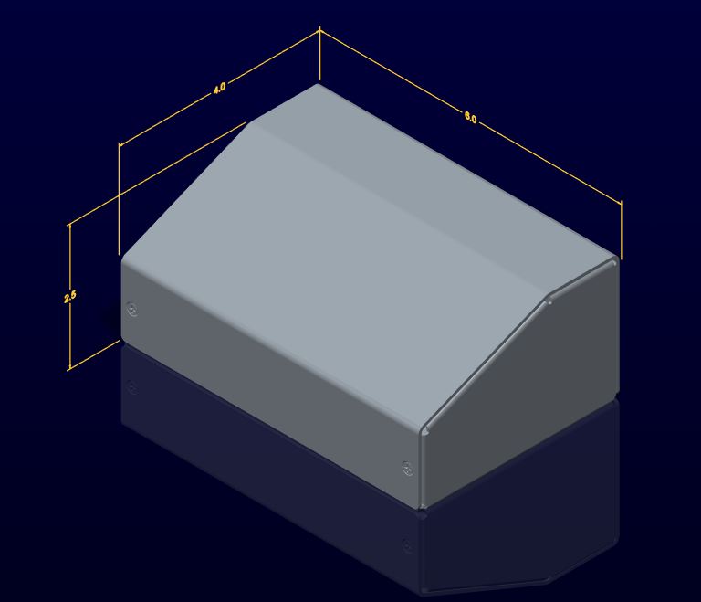

ISO Screen Capture

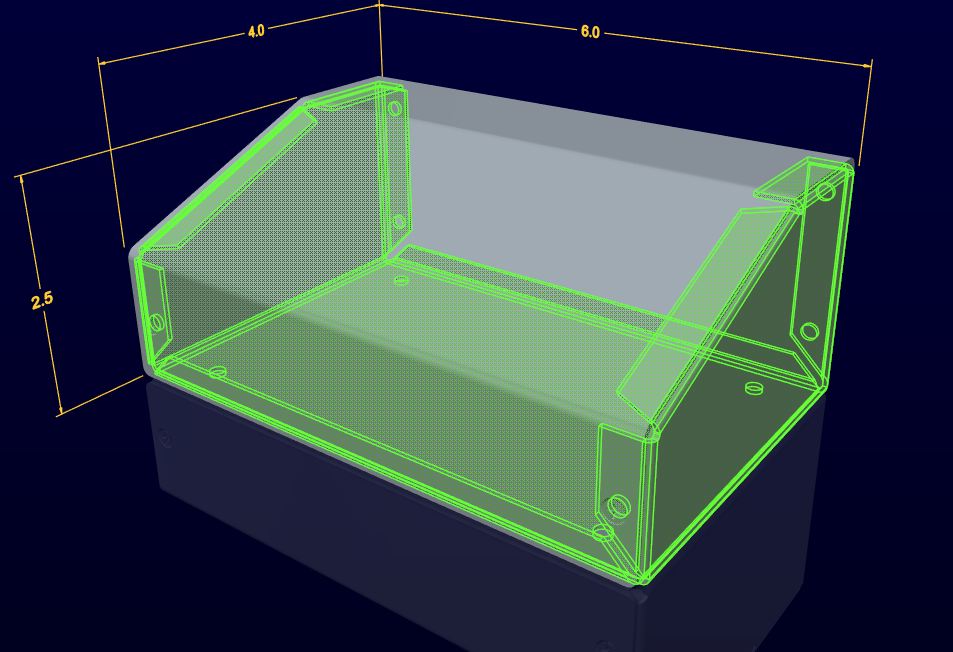

Highlite Screen Capture

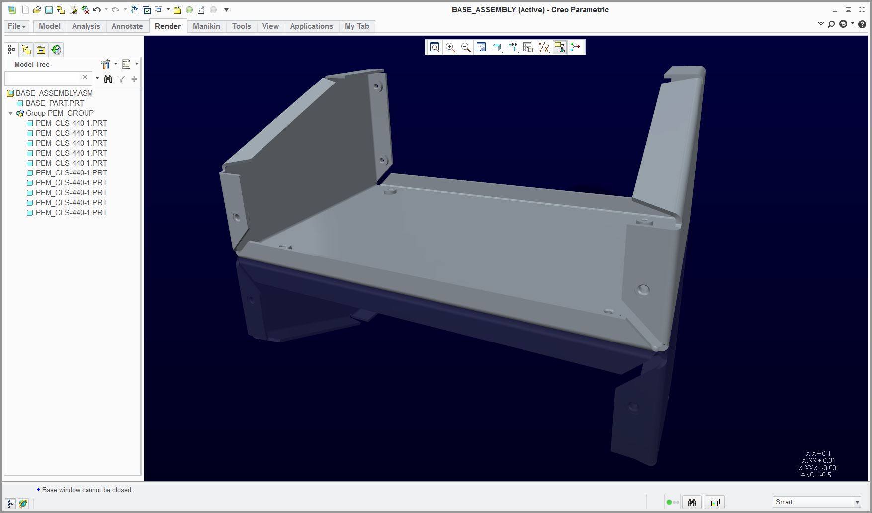

Inseparable Assembly PressFit Hardware Added

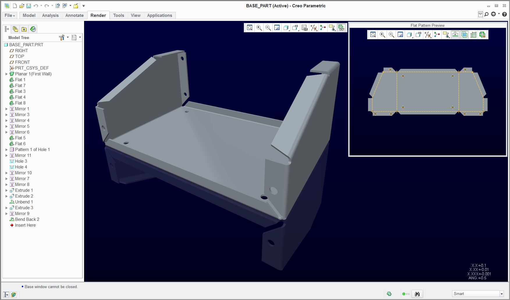

Base Flat Pattern

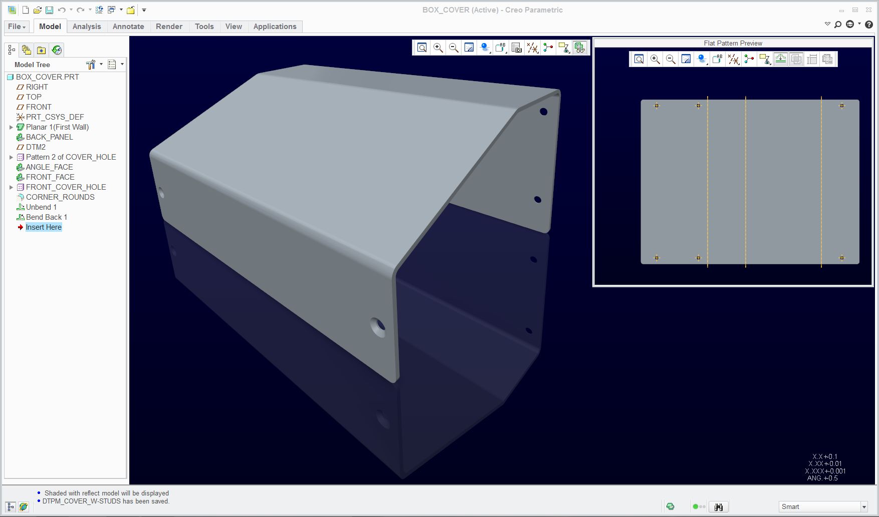

Cover Flat Pattern
