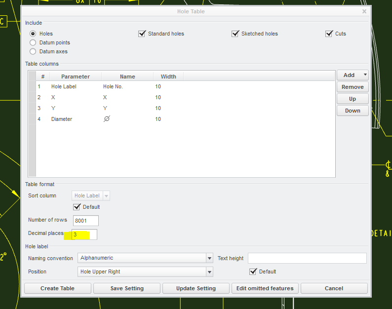

Hi all, I have a pattern table and I want to show the decimal places of the angular dimensions to 3 decimal places. I have changed the leader dimension to 3 decimal places, I changed the angular_tol to 3 decimal places, but the table still shows the dimensions rounded to one decimal place.  Any help is much appreciated!

What do you have default_ang_dec_places set to? Is it set to 1? If so try changing it to 3
default_ang_dec_places 3
You will have to re-create the dimension to test if this is it.

Your screen shot is from the hole definition of the pattern. I think your reference is in regards to the hole table that is on the drawing though? If that is the case, then there is a field for number of decimal places within the hole table dialog box.
Table tab -> Hole Table -> Decimal Places
If you are updating an existing table, select the "Update Setting" button first.
breiter1-VisitorAuthor

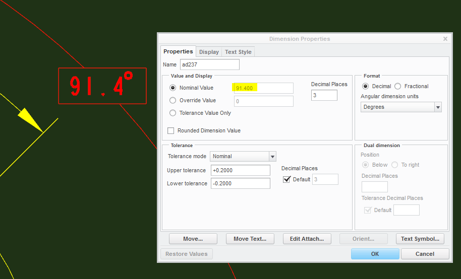

Chris, thanks for the response. I did try updating the hole table you mentioned above.  I should have mentioned this isn't a hole but a local group of revolves and extrudes (not sure if that makes a difference)
This might show it better. I would like the dimension to show as 91.385 degrees, if I edit the dimension in the pattern table it automatically rounds it to one decimal place.
