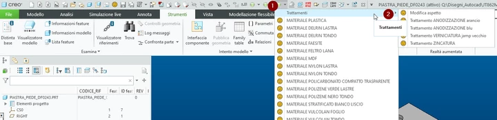

switching from Creo 2.0 to Creo 8.0 and 9.0 I am no longer able to nest two or more drop-down menus in the Quick Access Toolbar.
The example below is visible because I inherited the nested drop-down menu by importing the configuration of the old Creo 2.0.
Does anyone know how to do it?
Thank you.
P.S. i'm using Creo 9.0.0.0

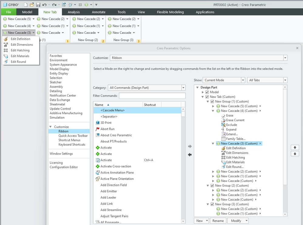

Sep 24, 2022 12:52 AM UTC
It seems like that ability has been removed.  The best I can do is create a new tab with multiple groups and then add cascade menus to each of those.  Cascade menus inside cascade menus is apparently no longer supported.
