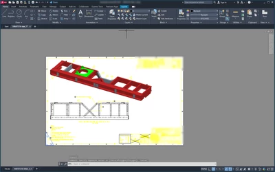

Hi everyone,
I was generating the DWG file from a drawing. Some views have the state "Shading With Edges" in the "View Display" properties. This is due to production porpuses and I cannot modifiy their representation.
During the saving operation, Creo displays a warning in the console, I attach the image below.
The resulting DWG file is incomplete, the biggest shaded views are missing on the drawing.
I tried changing some export settings, but nothing helped. Even exporting in DXF format resulted in an incomplete drawing, while PDF is ok.
Does anyone know how to solve this problem?
Thanks in advance.

create simple test drawing and export it. When you save dwg file, separate png file containing shaded picture should be created.
With your original drawing you can test setting of config.pro option DRAWING_SHADED_VIEW_DPI.
https://creosite.com/index.php/configuration/display-option/?srch=DRAWING_SHADED_VIEW_DPI&ver=creo11&mode=config

I set  the value to 100 and I was able to export a dwg file and upon opening in autocad, the shaded view was visable.

Hi everyone,
I tried different values for the parameters DRAWING_SHADED_VIEW_DPI, and it resulted in allowing the DWG file to be created correctly.
I had to use really low DPI resolution (25) but even in this conditions the images where good, being the drawing in format A0.
