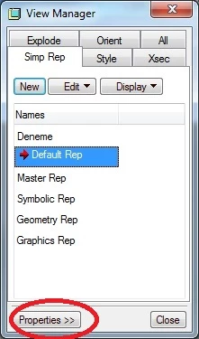

Hi Mark,
I don't know if you got any replies up to now, but here is the solution of your problem.
First of all, open the "View Manager", set the "Default Rep" active, and while "Default Rep" is selected, click "Properties" button on the left bottom of "View Manager" window. See rep01.jpg.

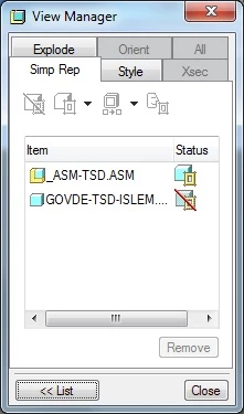

In this new window, you will see the main component, and the components that are excluded. For example, in rep02.jpg, second line is excluded, as you can understand from the icon next to it.

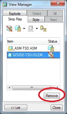

As you see in rep03.jpg, select all the excluded components, and then click the "Remove" button.
When you click the "List" button on the bottom left of the window, you will see the scene as in rep04.jgp.

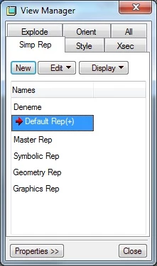

Just right click on "Default Rep(+)", select save. It will tell you that you are about to update the default rep, select update and you are done.
