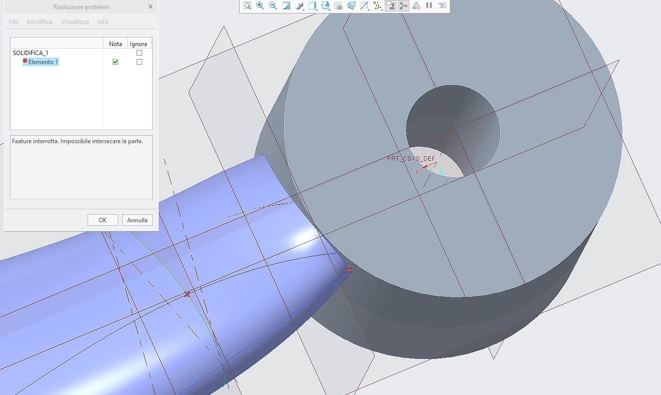

hii I have a problem during the solidification of a surface that penetrates inside a solid body. I attach the photo of the problem. I tried to fill the surface but having projected the curve onto the cylinder I can't select the surface to fill properly, could that be the problem?

In order to solidify a quilt in Creo it needs to be closed (think watertight). Without looking at your model it is hard to define the issue(s).

I tried to modify it recently and I managed to close the surface I was missing but it still gives an error. thi is the model

Just FYI, the model was created with the educational version of creo and can not be opened with the commercial version.
