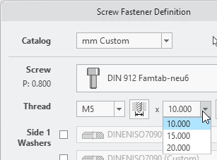

Hi everyone,
When I try to integrate a custom family table into IFX, I am unable to select a length, only the thread size.
The parameter LG does not seem to be readable. However, I cannot find any errors in the .PRT or .DAT files.
I have attached my original files.
We works with Creo 8.
Perhaps someone can help me?
Thanks in advance.

Inside your family table you only have one length for M4 and one length for M5.
So for M4 you only can select the length 8.0mm and for M5 the length 10.0mm
Please add more length for M4 and try again.

Hello Oliver,
thank you for your feedback.
But it doesn't work with more than one length, either.
See screenshot ...

The problem is this entry:
SUBINFO	MATERIAL
IFX cannot find the column MATERIAL.
You can remove this line or add a column MATERIAL to you family table and to your *.dat file.

I remove the subinfo with no effect ...

I have verified this again.
On my end the fastener could be assembled.
Find attached the modified *.dat and *.prt.
I have added 3 more instances with different lenght.
Which IFX version are you working within Creo 8. I have tested this with Creo 10.
Oliver Gräbner - B&W Software GmbH

Hello Oliver,
it looks like my .dat was wrong. I take your .dat and my .prt.
It works.
We work with the IFX 8.0.8.0
But I think it’s a problem, when I find for all of the Diameters I can select all of the lenght, although certain lengths are not available for certain diameters.

If you have a diameter M4 with 4 length available and you select M5 with no length available it should be possible that the length of the last selected diameters are shown. Normally no length should be available.
For IFX 8.0 we do not have support any longer.
Maybe you problem is already fixed in a newer version.
If required you can attach your problem-fasteners and I can review it.
