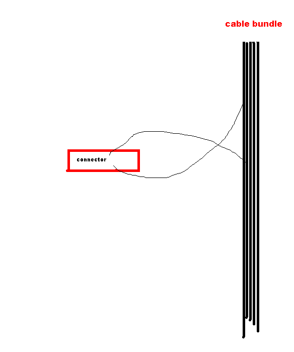

I am working on Cabling assemblies. I have layout of the wires on my assembly connecting different entry ports of different connectors to differentdentry ports of diffeternt other connectors following different networks or manual routings.
Problems i am facing are :
1. During flattening of the harness, when i fan out the cables to the connector it gives an error " insufficient wire length" I am unable to understand how to remove this problem.
2. In some cases we need to drop wire on a connector from both sides of the connectors as shown in the image. But when we flat the model we are unable to terminates the wires on same point, rather we get two segmants that do not terminate on same connector.
3. when in creat the from-to table of the wires it does not automatically poputale. I need a table that contains the details of all the wires i.e length of wire, starting connector, starting port, termination connector, termination port, etc
Best Regards

1) Remove the connector, then re-attach the connector to the shortest segment - As a side note routing all the conductors to a single csys and using the def_internal_len parameter will negate this problem
2) Send to tech support for investigation
3) Use attached table

Regarding the insufficient length:
Creo always attaches the connector to the shortest wire/cable, because this maximizes the chance that the other wires (which are longer) can fan out. However, if the longer wires need to reach more distant ports, this simple strategy may fail.
What you can do, is adding two or more bends to the shortest cable, to reduce the distance between connector and the failing cables until the other cables can be fanned out.

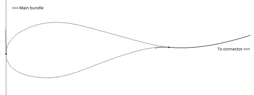

Try and make your main network like this
Rout a branch in 1 point instead of 2 points

In your case both side of wires (top & bottom as per picture) were creating closed loop. Move your flatten wire segment nearer to unflatten portion then try closed option.
---Ram
