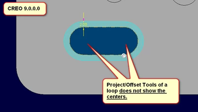

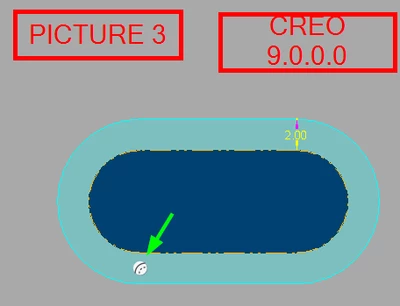

In creo 9.0.0.0 the project / offset tool does not generate the arc centers of a loop.

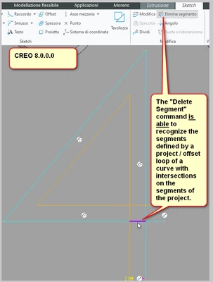

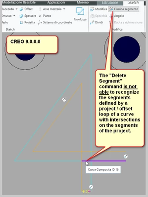

The "Delete Segment" command is NOT ABLE to recognize the segments defined by a project / offset loop of a curve with intersections on the segments and references.
P.S. Notice the yellow dots that delimit the recognized segments.

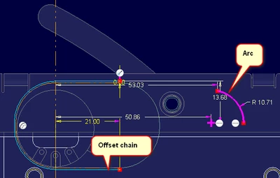

PROBLEM 4:
I would like my arc to have the same radius value as the arc of the offset chain, but the program does not allow me to set the constraint because it sees the entities of the offset chain as "a single group entity".

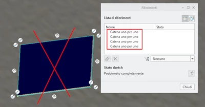

Reverting to the "old" command  is not supported in Creo 9.
The documentation indicates the ability to switch between chain selection to one-by-one.
"Switching from rule-based definition to individually selected items is supported for “Project”-tool"
Have you tested the method presented here?
https://www.ptc.com/en/support/article/CS369555

What they propose in the CS369555 to convert the chain to one-by-one for the "Project" tool may be reasonable, but I still don't like it.
What they propose in the CS369607 to convert the chain to one-by-one for the "Project / offset" tool with the "thickness" tool is unreasonable because, in my experience, the tool inevitably creates a double entity profile forcing the operator to select one by one all the entities of the second useless profile.

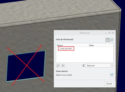

PROBLEM 5:
If in the sheet metal environment I try to close an opening with the "Wall" command, and then use the project to detect the profile, the feature goes into error ...
If I draw the outline without using the projection, it works!

Dear bmancnini,
thank you for your additional report #5, even though I don't think it is related to this topic/thread of modernized Project tool. as it seems this is a behavior also seen in previous versions. Actually when I quickly tried it now, I only saw it in prev versions and I couldn't reproduce it in Creo 9.0 anymore.
Therefore, I would encourage you to report a SPR to Technical Support along with the problematic Creo 9.0 example, so that R&D can have a look at it.
Meanwhile here some alternative workflows using parametric regeneration of the loop that worked for me. You can try them out:
a) Use the "Remove Feature" on the "Loop Surfaces" (by specifying the surface and an edge of the inner contour).
or
b) Use the planar wall feature referencing an external sketch containing the projected geometry
or
c) Use the planar wall feature with an internal sketch and projected entities as in your example, but check the Planar Wall feature option "Do not merge to model". Then use the separate "Merge Wall" feature to merge in a second step
best regards
September 14, 2022
I got a small update from R&D: a fix for this went into Creo 9.0.1.0

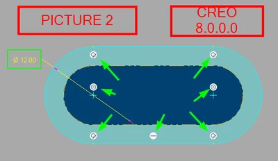

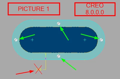

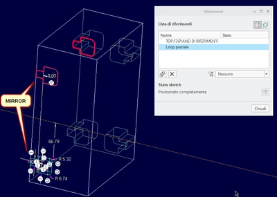

Usually with Creo 8.0 to create a counterbore slot for screw, I used the project offset command, then I deleted the relative offset dimension (Picture 1),
the program converted the "edge offset" constraints into coincidence constraints, tangency and horizontality and finally I added a dimension to the diameter of an arc of the slot, work completed (Picture 2).

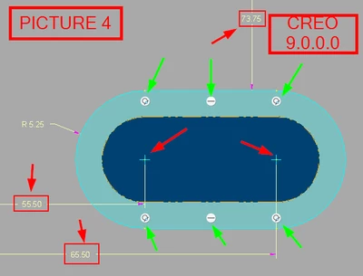

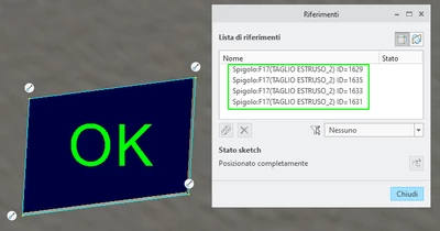

When I delete the offset value, the program converts the only offset constraint of the complete or partial loop (picture 3)
into tangent and horizontal constraints but not coincident in the centers of the arcs ... (Picture 4).
This behavior is partly attributable to other unwanted behaviors that I have already reported in other points of this discussion, but I wanted to report it anyway because, for me it is a basic use of the project offset command.
