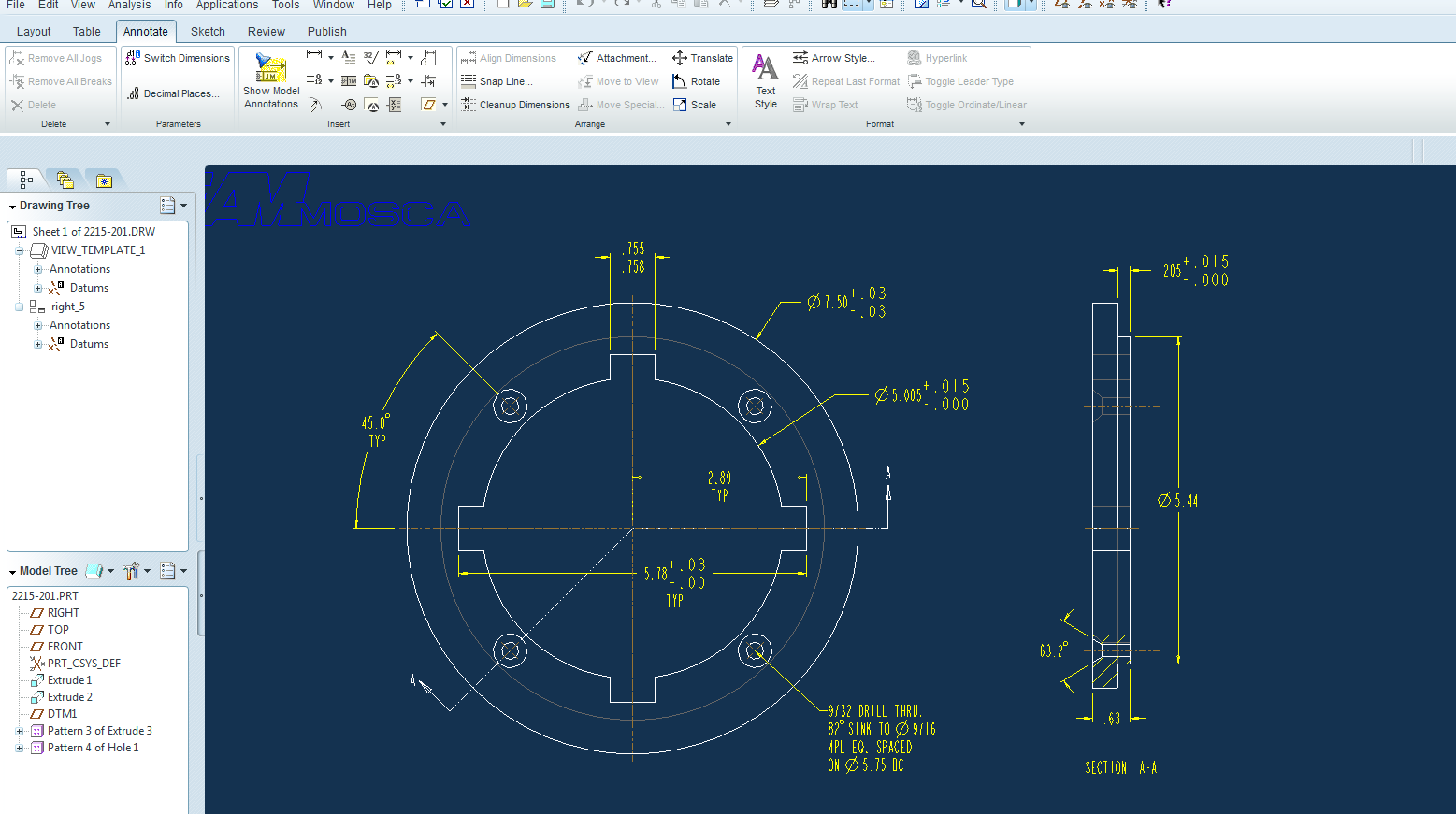

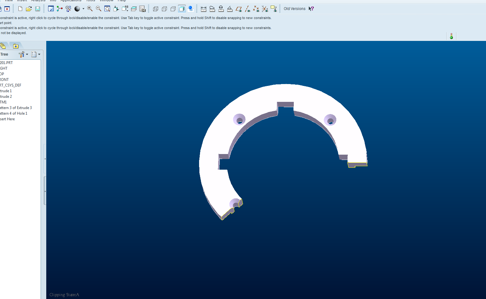

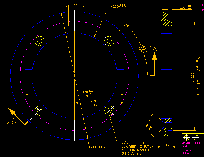

I created a part according the dwg drawing:
I made a offset XESC:
and drw:
Obviously, the right section view is different as dwg drawing due to it is a straight right view, not a rotated projection view as dwg showed which I want.

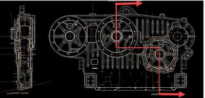

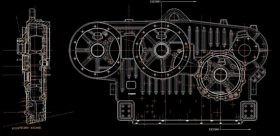

Aug 9, 2018 4:12 PM UTC
hi mahesh,
i'm having the same issue, i know the procedure for aligned section view but after following all this i'm getting this error " All lines in cross section must intersect axis.  Pick another axis " which axis needs to be picked for aligned section view.
I have tried all axis randomly available in model , See attached picture of drawing and what I'm trying to do.
StephenW
Aug 9, 2018 5:12 PM UTC
The way you have it drawn with the angled line would make it need to rotate around 2 axis to align. Make the line horizontal in between the vertical lines then you don't need to use an aligned section, just a normal offset x-section.

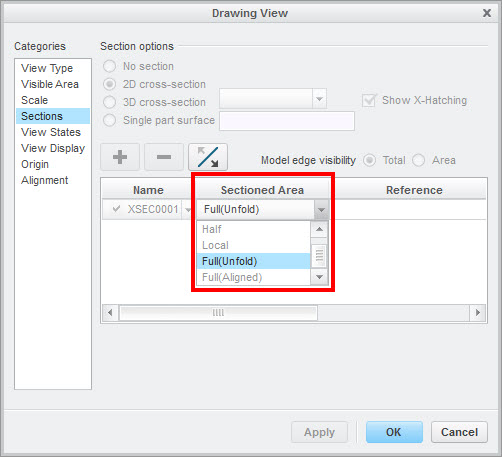

Sep 17, 2016 12:00 AM UTC
Are you trying to make the unfolded section view? You need to put in a general view (not a projection). Then, in the section definition, select Full(Unfold) in the drop-down of the Sectioned Area portion.
bxu1-VisitorAuthor
Sep 20, 2016 1:05 PM UTC
Hi, friends,
It works just followed you guys advice.
Thanks a lot.
