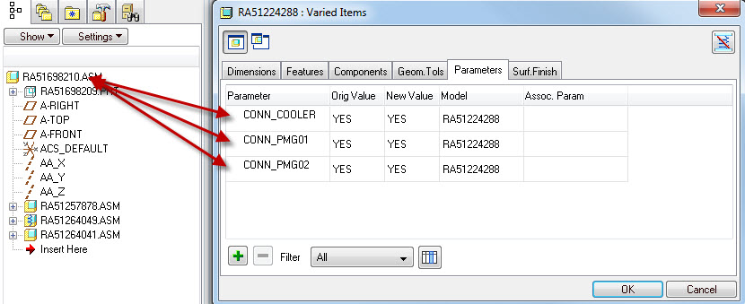

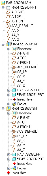

1) First you built a model/modeltree with all components in it.
2) After that you are going to add parameters to the sub-level assembly which you want to be flexible.

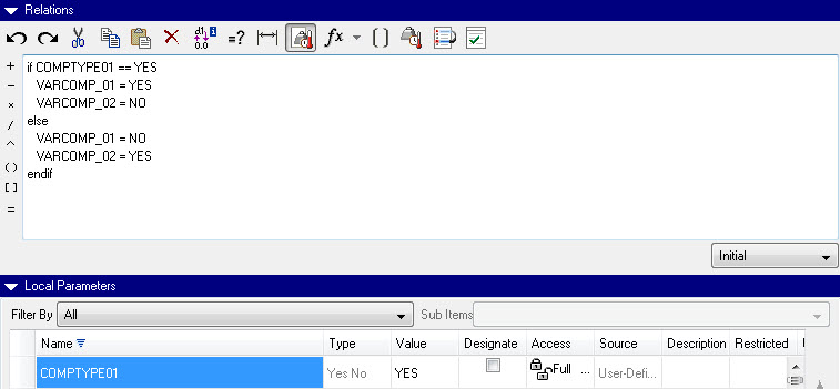

3) These parameters will be controlled by a relation which looks as follows.
Note that in this step an additional main controlling paramters is created. (COMPTYPE01)
4) Now the components need to be placed/suppresed according to the parameters VARCOMP_01 and VARCOMP_02.
You do this by adding relations to ProPROGRAM. These look as follows.
Now the subassy can be controlled through the parameter COMPTYPE01.

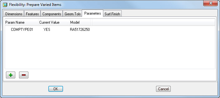

5) Now the subassembly needs to gain some flexibility.
Add the parameter COMPTYPE01 to the flexibility menu in the subassembly.

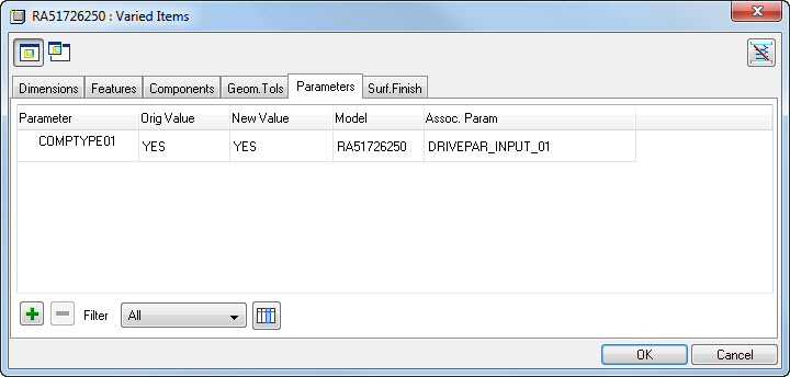

6) In the upper-level-assembly we need to give the subassy it's flexibility. In this menu we also assign a 'Assoc. Param' to the parameter COMPTYPE01.
See the explanation from Vlad in this discussion to get some more information about this 'Assoc. Param'.
In short it means that parameter COMPTYPE01 will copy the value from the 'Assoc. Param' that has been assigned to it. In this case DRIVEPAR_INPUT_01.

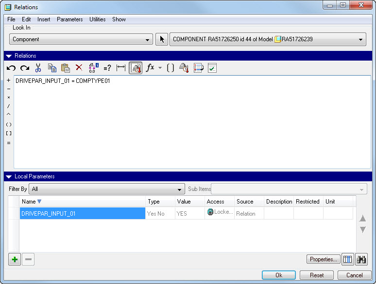

😎 In the last step we will need to define the link between the 'Assoc. Param' DRIVEPAR_INPUT_01 and the upper-level-assembly paramter COMPTYPE01.
This needs to be done by a relation which is located in the Component of the flexible object, so not in the Sub-assembly.
When navigating with the relations menu to the Component which is flexible the local paramter DRIVEPAR_INPUT_01 can be seen. A relation with the upper level
assembly can be defined from here without using a component ID behind the relation. Just enter the upper-level-assembly parameter into the relation.
